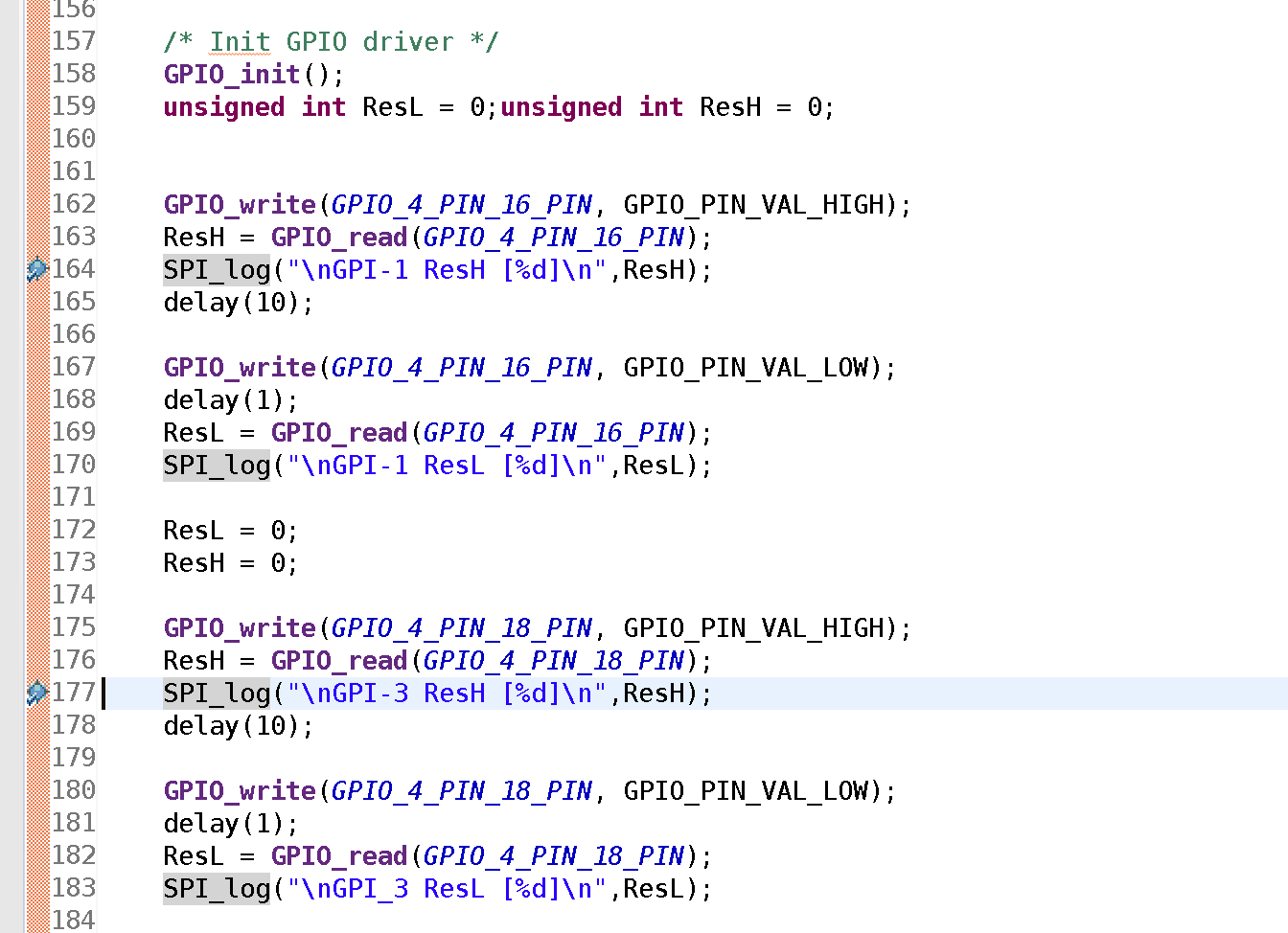

    Sorry for the inconvenience. It was a typo mistake. Actually we made the configuration in "SPI_idkAM437x_board.c" file.
    We found some strange behaviors, In same GPIO bank(GPIO4) one of the PIN(GPIO4_16) working as expected but another  PIN(GPIO4_18) not working. We have attached the following files & registry dump for your reference.
    Used Project: ti/pdk_am437x_1_0_15/packages/MyExampleProjects/MCSPI_BasicExample_idkAM437x_armExampleProject
    1. Source Code snippet
    File: main_mcspi_example.c
    File: SPI_idkAM437x_board.c
    2. Register Dump files
       GPIO4_16_Working.txt
    GPIO4_18_Not_Working.txt
    We have ordered the AM437x IDK to check this issue. But it takes a week to arrive. So kindly do us a favor to check our attached SD CARD boot binaries in your setup & share us the log files. Since we are in a very critical situation. Kindly support us.

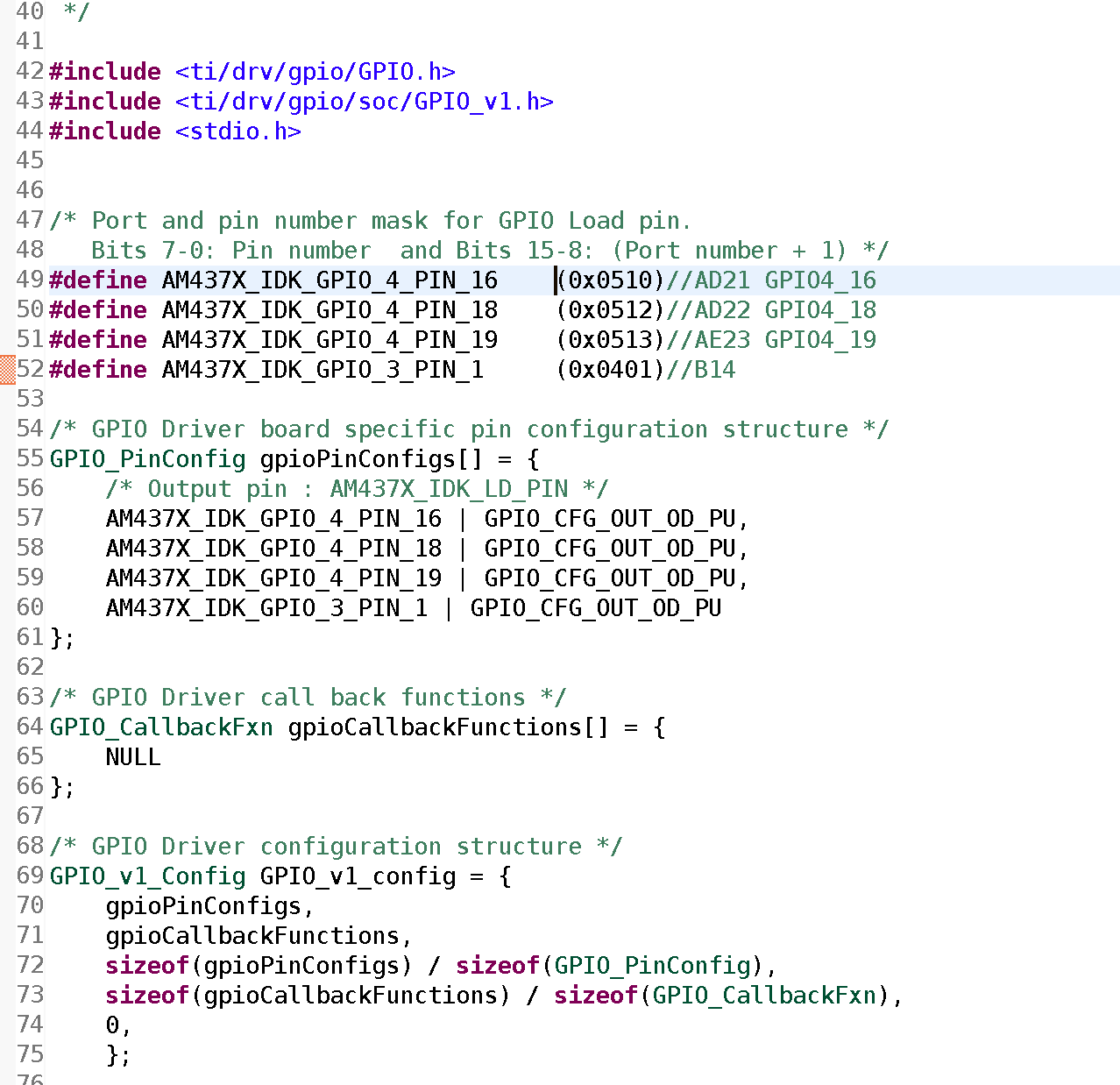

  • Suresh,
    I see in your log files:
    "CONTROL_MODULE_CTRL_CONF_CAM1_DATA2 0x0000000B 0x13060007"
    "CONTROL_MODULE_CTRL_CONF_CAM1_DATA4 0x0000000B 0x13070000"
    This means pin AD22 cam1_data4.gpio4_18 is NOT configured properly.
    In am43xx_idkevm_pinmux_data.c file, we have cam1_data2.gpio4_16 setup, but not cam1_data4.gpio4_18 setup. I would suggest you to update the default am43xx_idkevm_pinmux_data.c file like below, and that should be the only update regarding cam1_data4.gpio4_18 pin.
    static pinmuxPerCfg_t gGpio4PinCfg[] =
            /* My GPIO 4 -> gpio4[16] -> AD21 */
            PIN_CAM1_DATA2, 16, \
                PIN_MODE(7) | \
                ((PIN_PULL_UP_EN | PIN_RX_ACTIVE | PIN_DS_VALUE_OVERRIDE_EN | PIN_DS_OP_DIS | PIN_DS_PULL_UP_EN) & \
                (~PIN_PULL_UD_DIS & ~PIN_DS_OP_VAL_1 & ~PIN_DS_PULL_UD_EN & ~PIN_WAKE_UP_EN))
       +     /* My GPIO 4 -> gpio4[18] -> AD22 */
       +     PIN_CAM1_DATA4, 18, \
       +         PIN_MODE(7) | \
       +         ((PIN_PULL_UP_EN | PIN_RX_ACTIVE | PIN_DS_VALUE_OVERRIDE_EN | PIN_DS_OP_DIS | PIN_DS_PULL_UP_EN) & \
       +         (~PIN_PULL_UD_DIS & ~PIN_DS_OP_VAL_1 & ~PIN_DS_PULL_UD_EN & ~PIN_WAKE_UP_EN))
    Pavel

  • Suresh,
    Your am43xx_idkevm_pinmux_data.c update looks correct. Please make sure you are building new MLO file based on your update. Refer to below user guide for re-building MLO file:
    Pavel

    Sorry for the delay, I needed some time to check this on my side.
    SURESH p said:
    I have doubted the pin muxing is happened in the application, not in MLO am I right?
    Yes, you are correct. When updating am43xx_idkevm_pinmux_data.c file, you need to use the same MLO and new app file.
    Pavel
