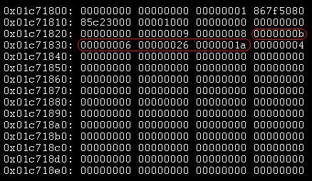

    Have you checked whether your settings fro ROI are really getting reflected on the Face Detection registers? Can you provide the dump of FD registers?

    Yep, I have checked the Face Detection registers. It seems normal to me.

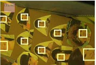

    I set the ROI as (11,6,38,26), the the register dump as follow, there are 9 face detected(at that time according to the registers)^^|||........but none of them are in the ROI^^||
    I have no idea what's happened><........
    The result as follow
