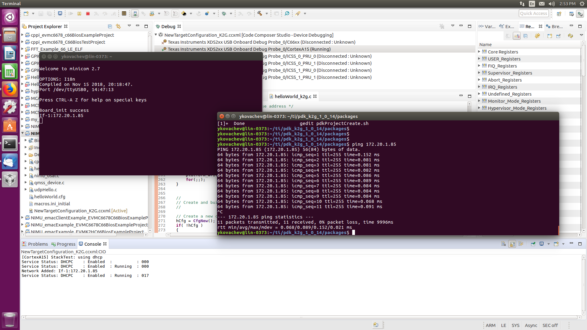

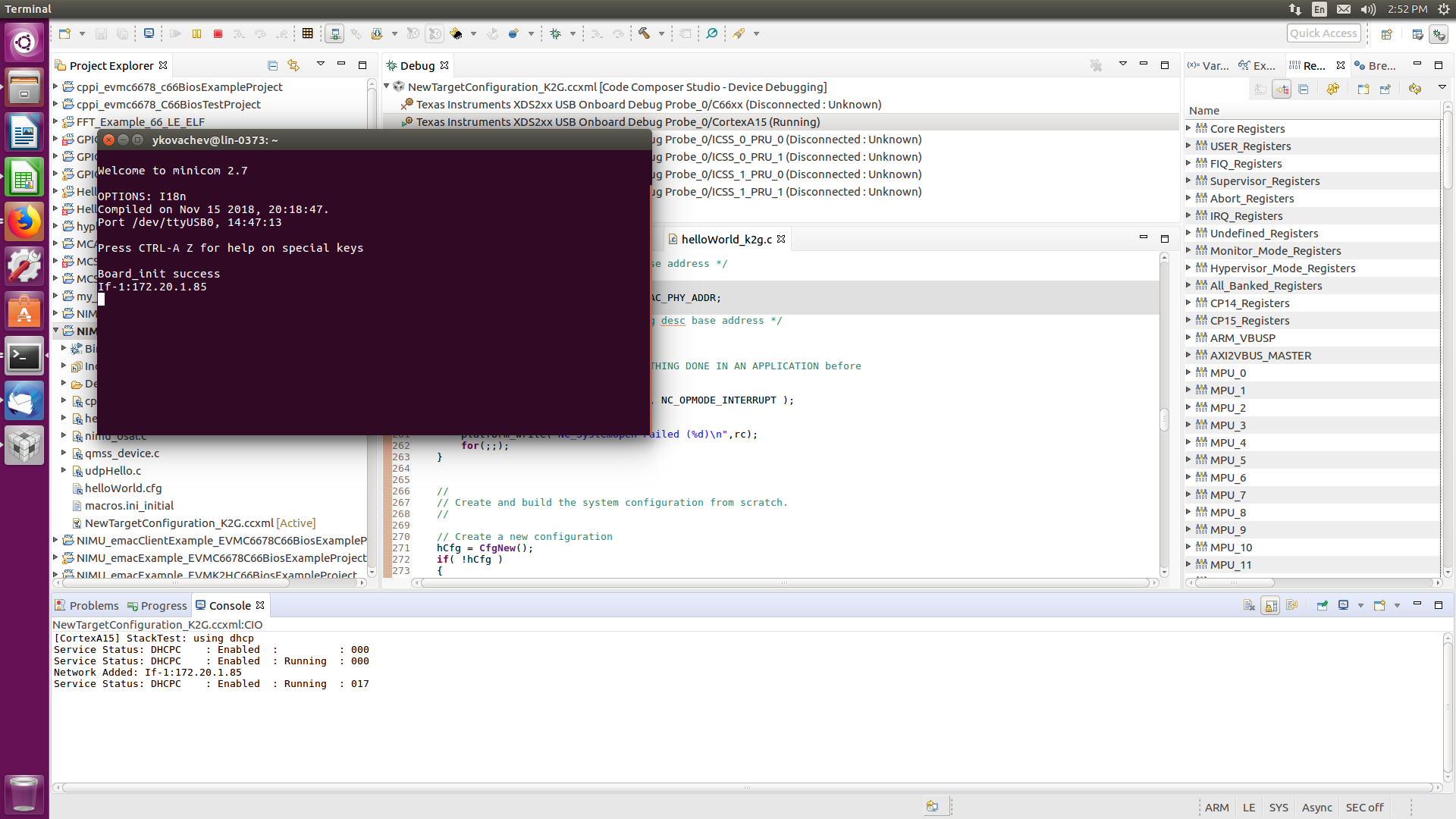

  • Hi Brett,
    I tested the NIMU_BasicExample_evmK2G_armExampleproject on my side.
    I created the project as follows:
      installed the latest Processor SDK RTOS and opened CCS to install the new components
      then executed the following commands to create the project:
      ykovachev@lin-0373:~/ti/pdk_k2g_1_0_14/packages$ source pdksetupenv.sh
      ykovachev@lin-0373:~/ti/pdk_k2g_1_0_14/packages$ ./pdkProjectCreate.sh K2G all little nimu all arm
    Imported the project in CCS, built it and ran it on EVMK2G. The result is as follows:
    In CCS Console I get:
    From UART console:
    And the ping is running as expected:
    Can you try fresh, following the above steps?
    Yordan
