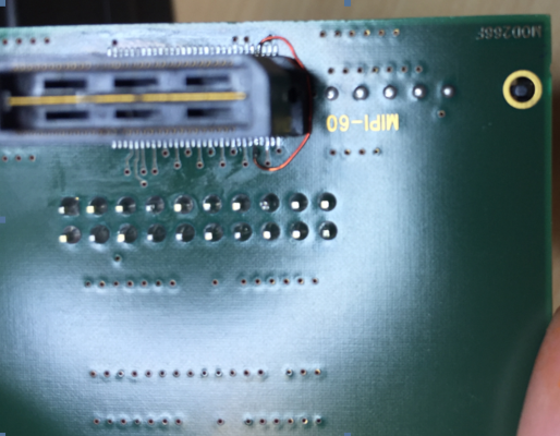

    Were you able to resolve your connection issue? I did see some internal traffic where your group was OKed to get the necessary collaterals. Also, it appears that you all may have needed to update a legacy adaptor.
    To expand: The recommended trace adaptor is the LA-3818 as it supports (as delivered) all the trace lanes which the board routes 22 of 24. An older OMAP4 style adaptor like an LA-3812 only supports up to 18 bits. To use the older adaptor on DRA7xx or DRA8xx a modification is needed to tieing resets together (see attached picture). For non-trace, the adaptors with the EVM kit along with a legacy cTI20 or TI14 connector will work.
    Legacy Modification:
