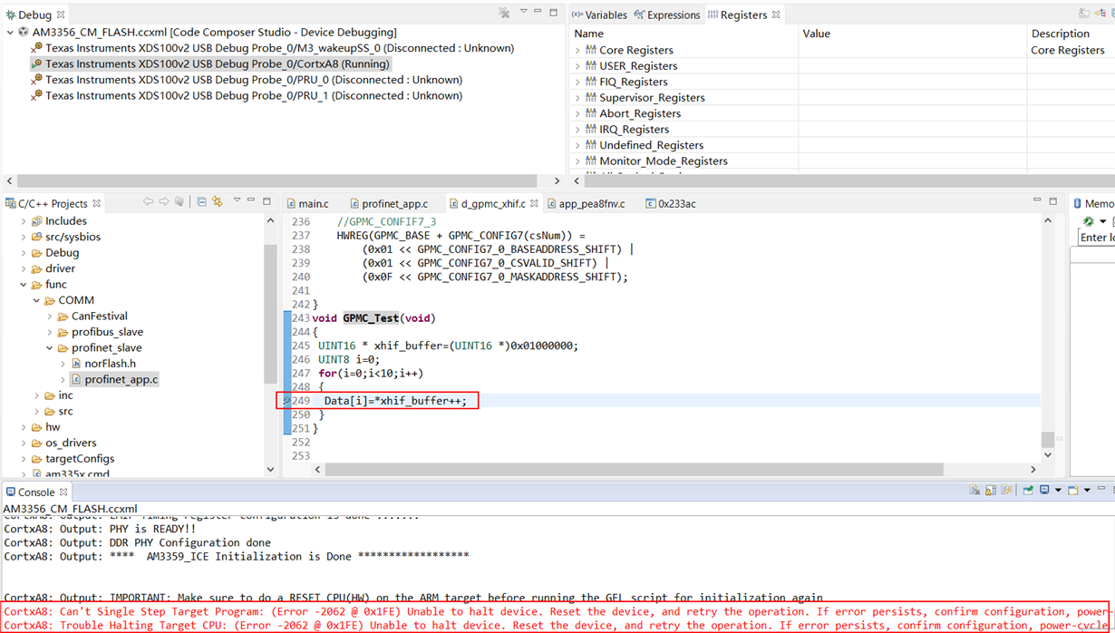

The program crash after the breakpoint.

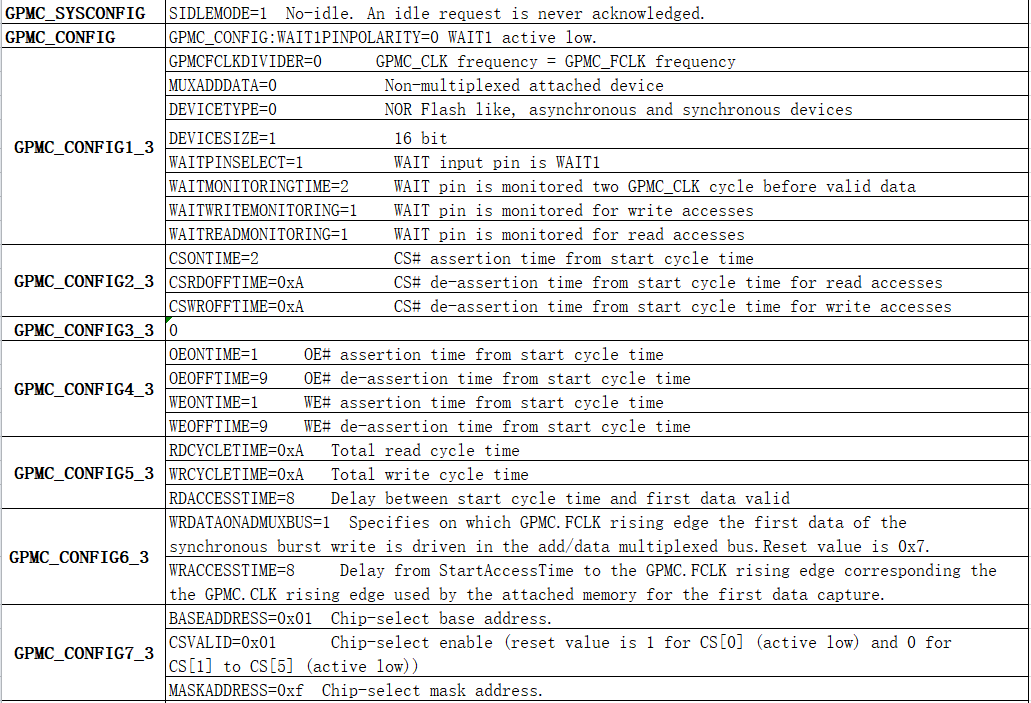

I find that the program run ok when I do not configure the Wait1 pin.So I suspect the crash has something to do with the Wait1 pin.
I have two doubts.
1,What causes this problem(Can't Single Step Target Program: (Error -2062 @ 0x1FE) Unable to halt device.) ?
2,It caused the crash because the AM335x did not wait the Wait1 signal. Is it possible ?
    Yes, it is possible, it looks that you used the wait1 pin for GPMC read access. Please look at the AM3358 TRM, 7.1.2.3.8.3 External Signals:
    • WAIT Pin Monitoring Control
    • A-SYNC/SYNC read access
    If your configurations violate this.
