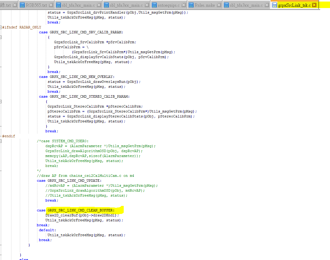

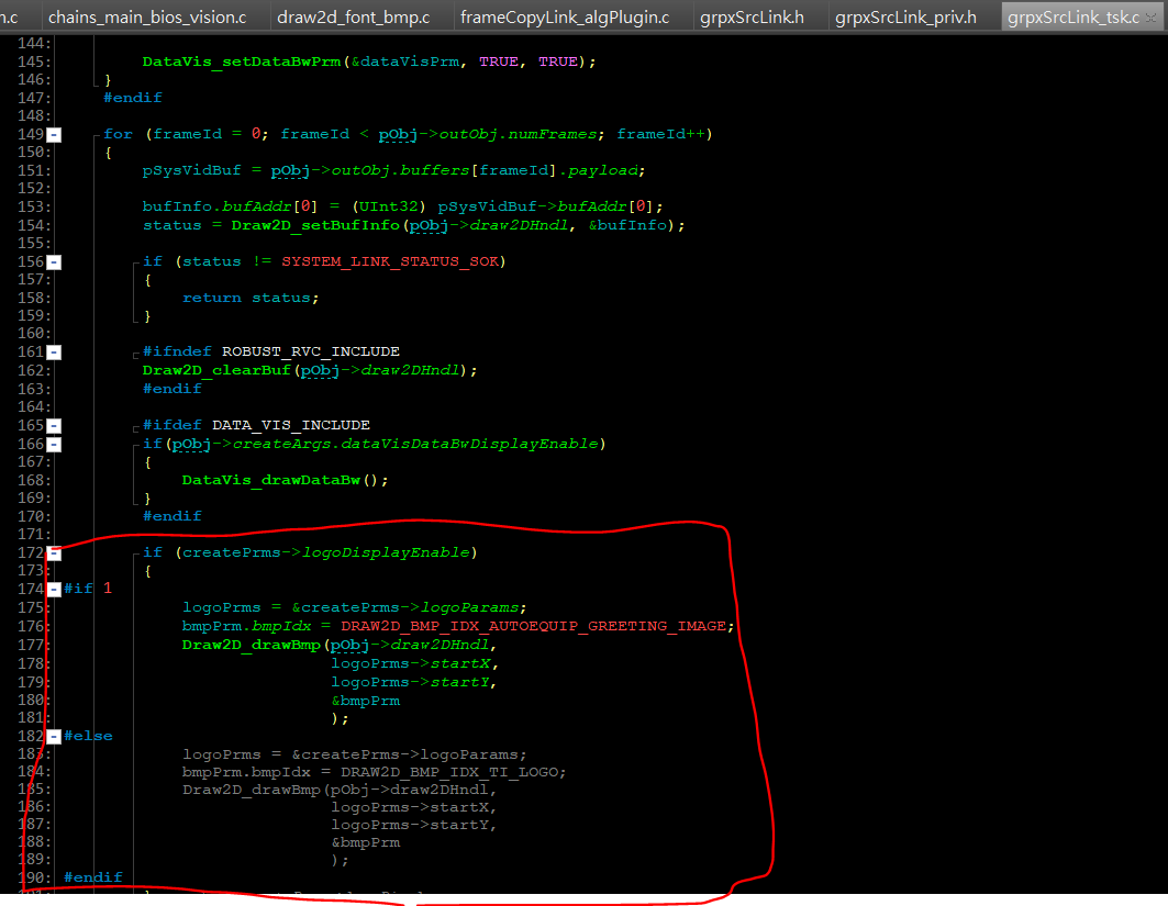

I use the Draw2D_drawBmp function to draw and then use Draw2D_clearBuf function clear buffer after delay 1 second.
Some points appear background color when switching

Can you make sure cache is flushed after clearing buffer?

Can you try with Draw2D_clearRegion( ) api and clear the entire region of your bmp.

I have found the issue, because I think the color 0X0000 is black, but after testing it is found to be through the first layer of the camera display
Q : If I need to draw a black color in GRPX, how should the color be set?
Please check in draw2d module there should be such example.
Anuj
This is a very small module and has been developed for very minimal purpose.
So we have not tried and tested all combination of colors and other things.
You can give it a try itself for this color format and check whether you get the expected result or not.
