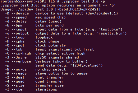

1. Executing just the binary provides the following output.
2. These are the following options that are accepted by the test application.

    spidev_test -l option set spi mode to SPI_LOOP, check below file:
    linux-kernel/tools/spi/spidev_test.c
    static void parse_opts(int argc, char *argv[])
    switch (c) {
    case 'l':
                mode |= SPI_LOOP;
                break;
    And SPI_LOOP is NOT supported for AM65x McSPI module and AM65x McSPI linux driver:
    linux-kernel/drivers/spi/spi-omap2-mcspi.c
    For example, you can compare SPI_LOOP mode with SPI_CS_HIGH mode, which is supported for AM65x device and software.
    You need to run below command:
    am65xx-evm:# ./spidev_test -D /dev/spidev3.0 -v
