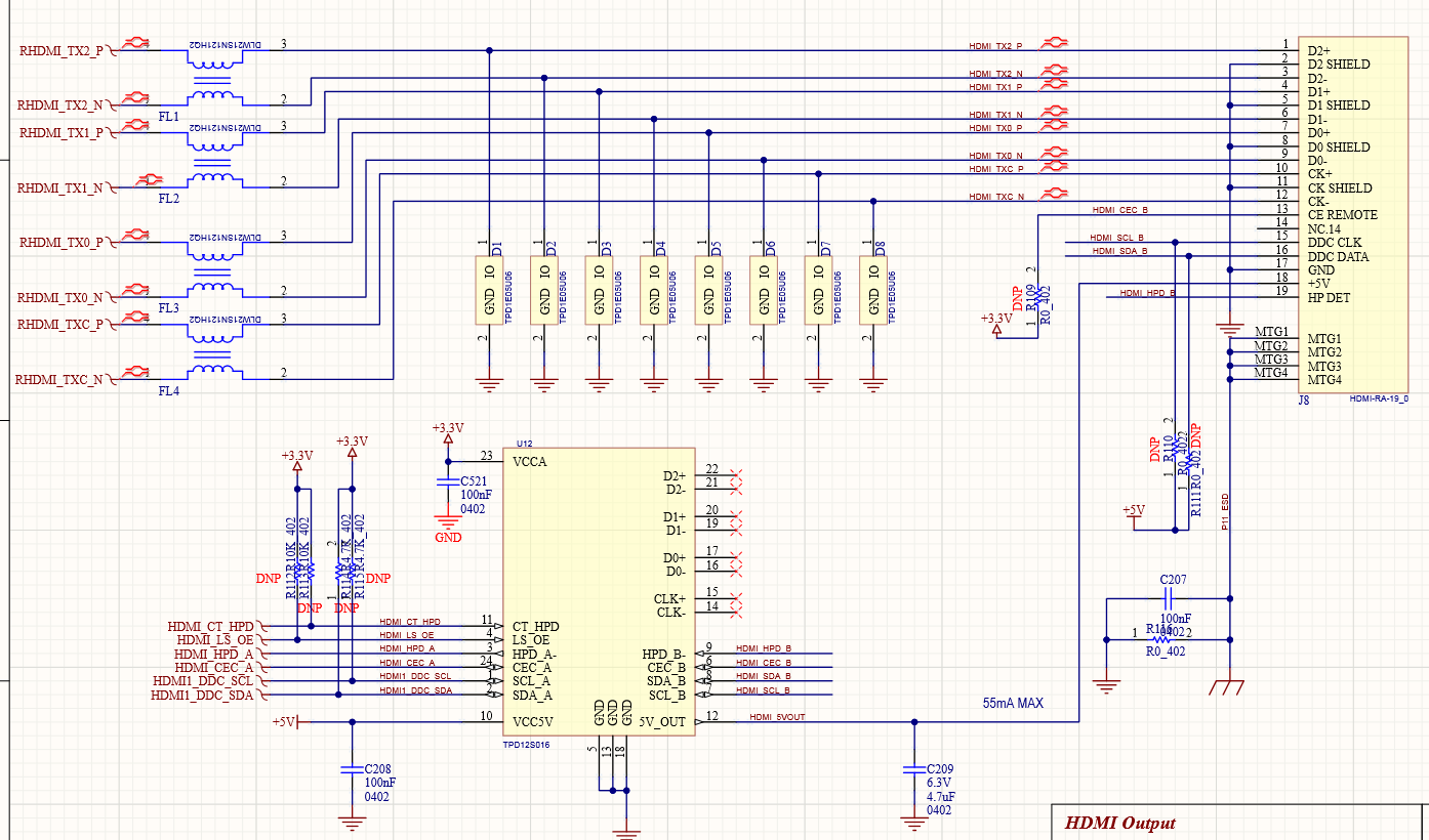

Hi
I have custom board based on EVM. There is a problem with HDMI running SDK 06.00.00.07. The Output resolution is not FullHD. I also get some errors when trying to run PowerVR Demos.
root@am57xx-evm:~# dmesg | grep HDMI
[    2.811815] omapdss error: HDMI I2C Master Error
[    3.918656] omapdss error: HDMI I2C Master Error
[   19.029378] omapdss error: HDMI I2C Master Error

And this is schematic based on the EVM (Resistors marked with DNP have not been populated as EVM):
  • Problem Solved!
    There was a mismatch in HDMI LS OE gpio pin connected to level shifter. The default was gpio2_30 but it is connected to gpio2_31 in our board. I have corrected it in am57xx-beagle-x15-revc.dts file and the problem solved.
