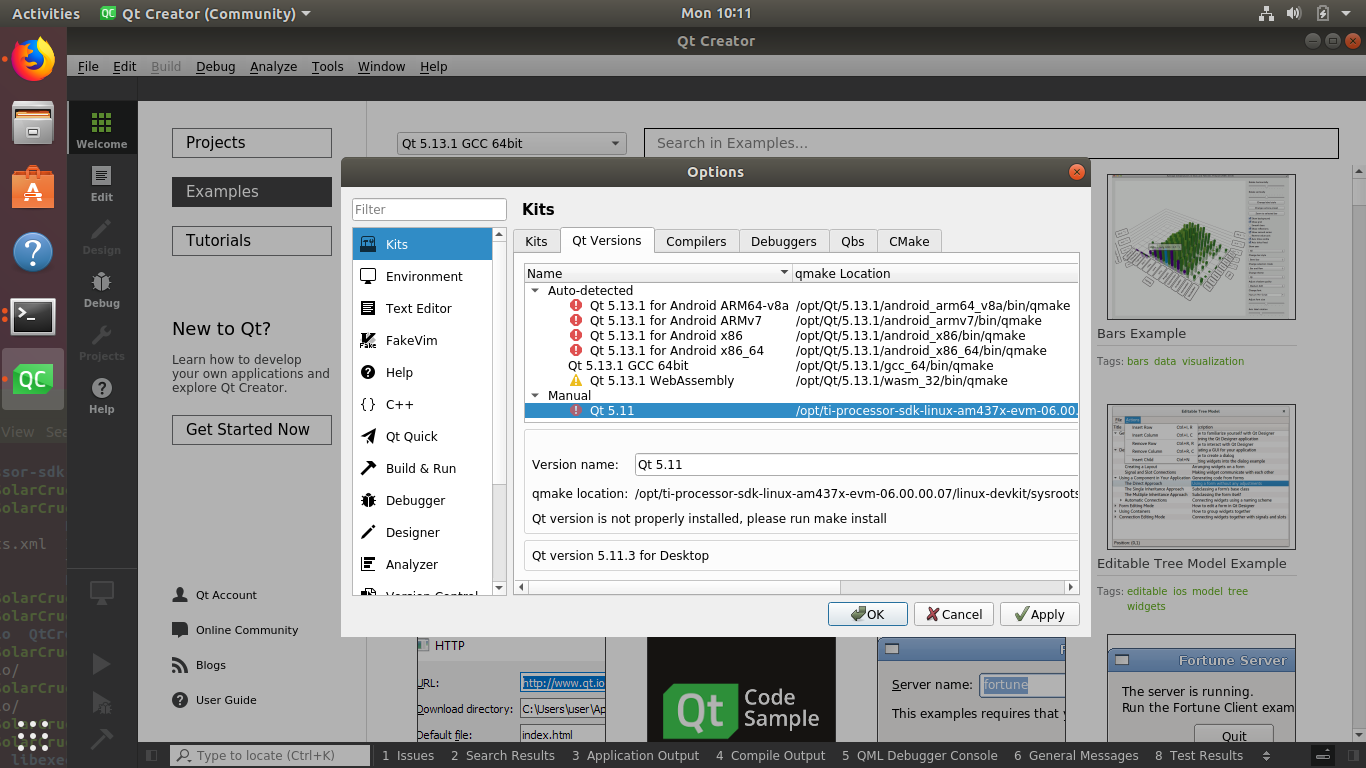

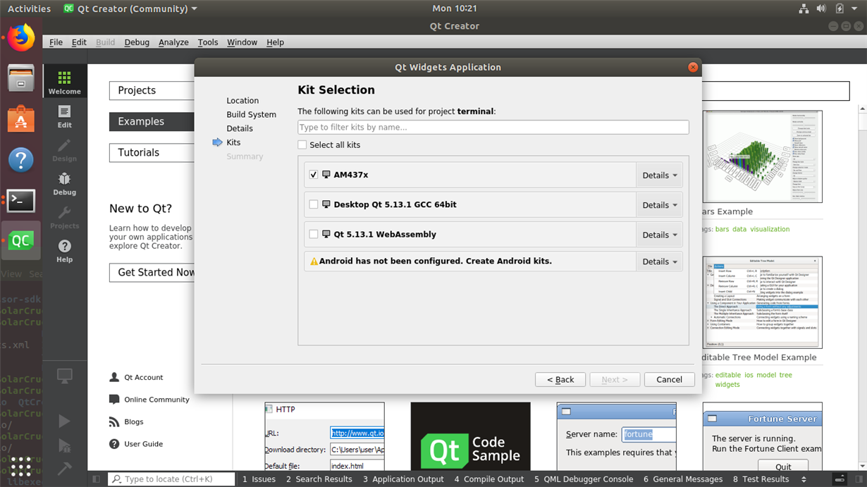

Good day,

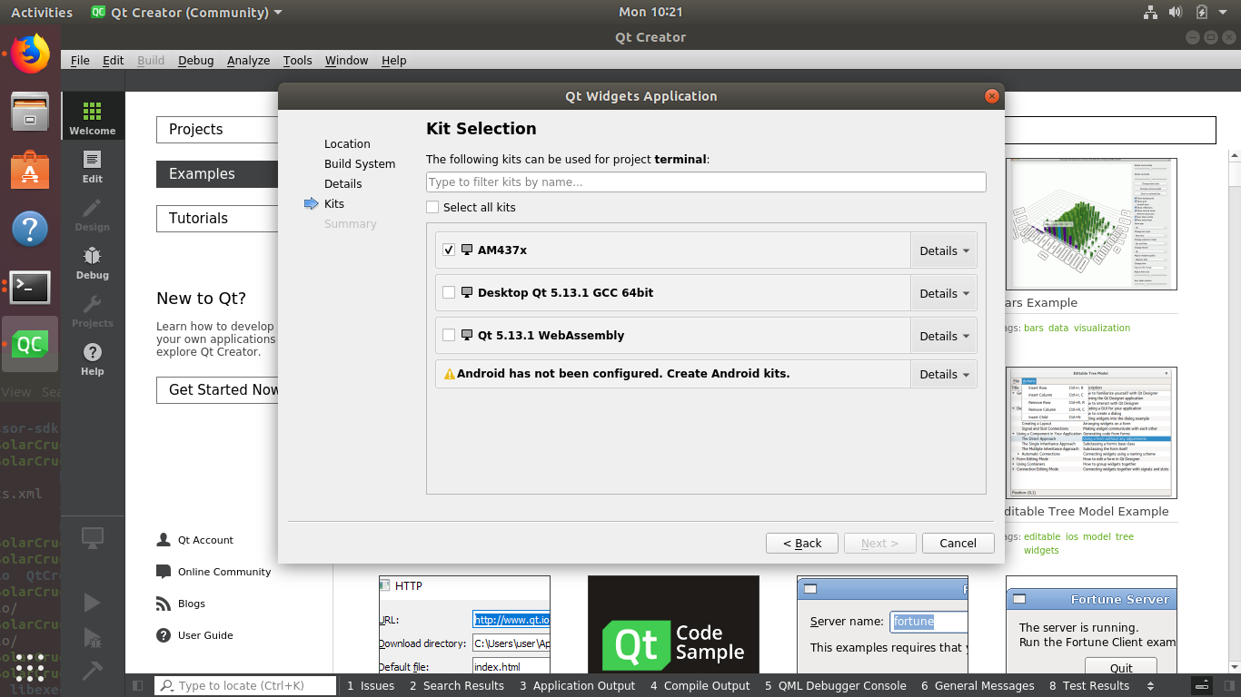

I have followed all the steps in this guide for QT creator: Here
However, once I complete the step which asks to choose a kit for the project, the manually selected qmake from the SDK (labelled as AM437x in the list) does not allow me to proceed. Furthermore, when selecting the qmake from the installed SDK, there is a red '!' icon beside the Qt Version with the error "Qt version is not properly installed, please run make install". I am running Qt composer on a Linux Ubuntu 18.04.3 LTS operating system. I have installed libraries using "sudo apt-get install build-essential" and "sudo apt-get install libfontconfig1" , "sudo apt-get install mesa-common-dev" and "sudo apt-get install libglu1-mesa-dev -y".
I have downloaded the SDK from TI through this link.  I followed the instructions for SDK installation using the setup.sh file. Another issue I found was that I could not find the qt5 directory in this location:
cd /home/sitara/AM335x/ti-processor-sdk-linux-<machine>-<sdk version>/linux-devkit/sysroots/cortexa8hf-vfp-neon-linux-gnueabi/usr/include/qt5
and instead of cortexa8hf-vfp-neon-linux-gnueabi, it was x86-x64-arago.. for me.
I will update this post with any required information (such as screenshots, linux codes) upon request.

  • Hello Shoaib,
    Please, refer to this, this, this, this, this and this thread. You have to first source <Processor SDK>/linux-devkit/environment-setup script before invoking qtcreator from the same terminal window.
    Kemal

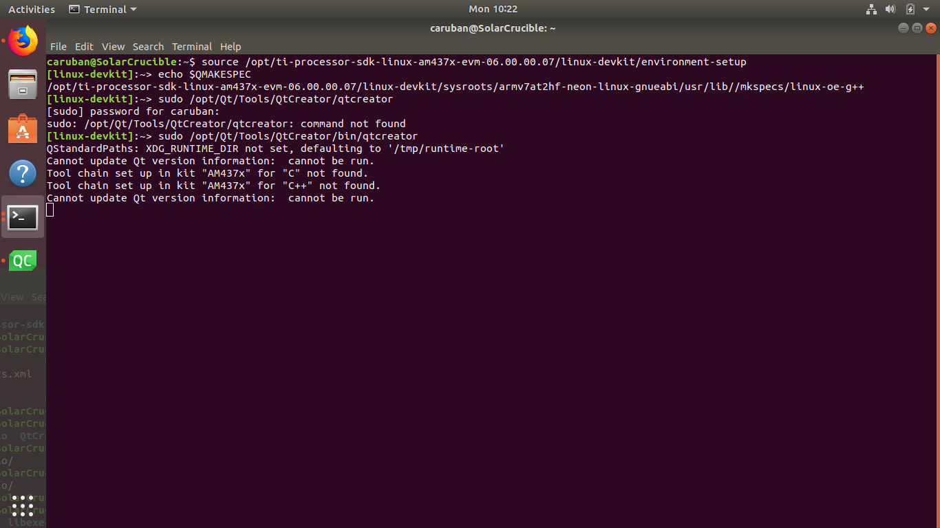

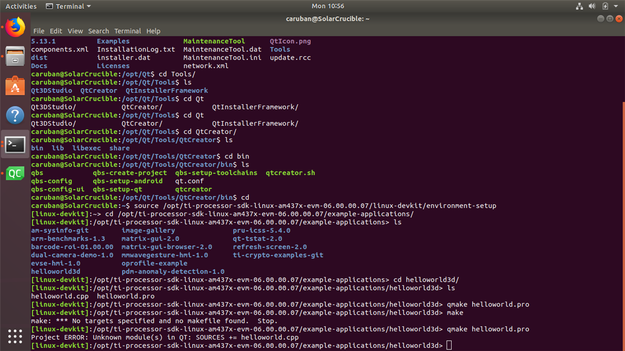

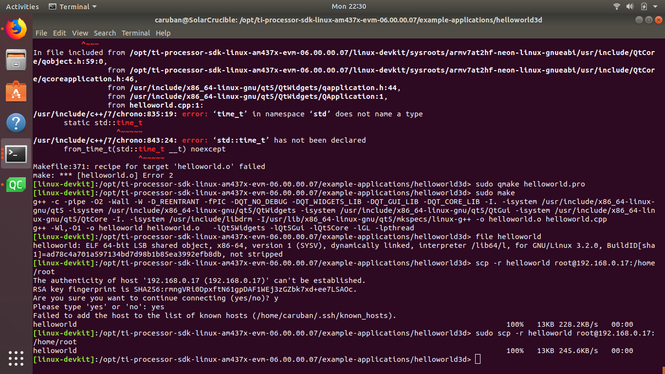

  • Hi Kemal,
    Thank you for the reply. I have done as instructed and sourced the environment-setup file.
    I have redone all the steps of LAB 2 of the Hands on with Qt exercise although it still says that my Qt version is invalid.
    I have attached 3 screenshots: the terminal window, Qt project creation window, and the Tools>Options window of Qt.
    Please advise if you need any other information.

  • Can you use sudo -E commands instead of sudo and retry?
    Shoaib Muhammad said:
    "Project ERROR: Unknown module(s) in QT: SOURCES += helloworld.cpp"
    Please, see this thread about this issue.

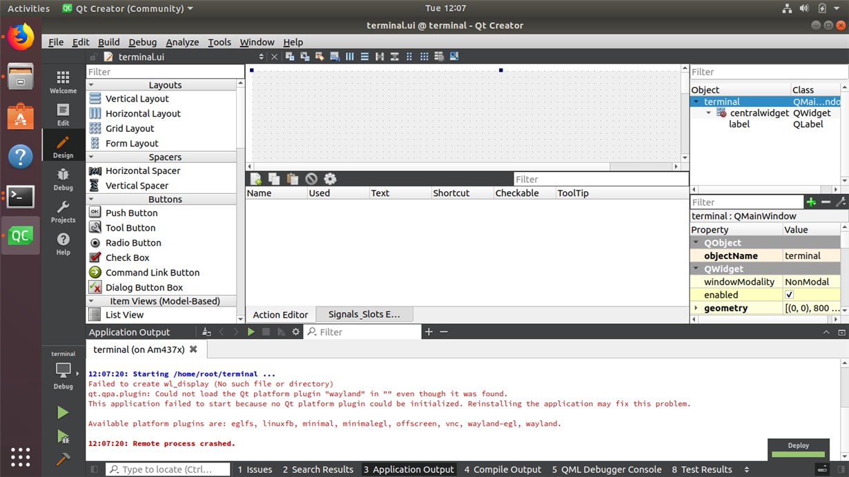

  • Hi Kemal,
    Thank you very much I truly appreciate it. I was able to proceed on both LAB1 and LAB2, however, i am faced with new errors when running both files. Under the "QT version" tab the red "!" icon was replaced with a yellow icon and the text "No qmlscene installed" appeared. I have followed the instructions on one of the posts you referred to above to remove the version and add the qmake back, this time with the environment-setup sourced. It did not solve the issue. Running LAB1 and LAB2 output files from the serial minicom terminal also yielded the same errors.
    Furthermore, after following LAB2, just after clicking Run "green arrow", an error message "error while loading shared libraries: libGLESv2.so.2 appears. Please refer to the screenshots for a clearer picture and information.
    Kind regards,
    Shoaib

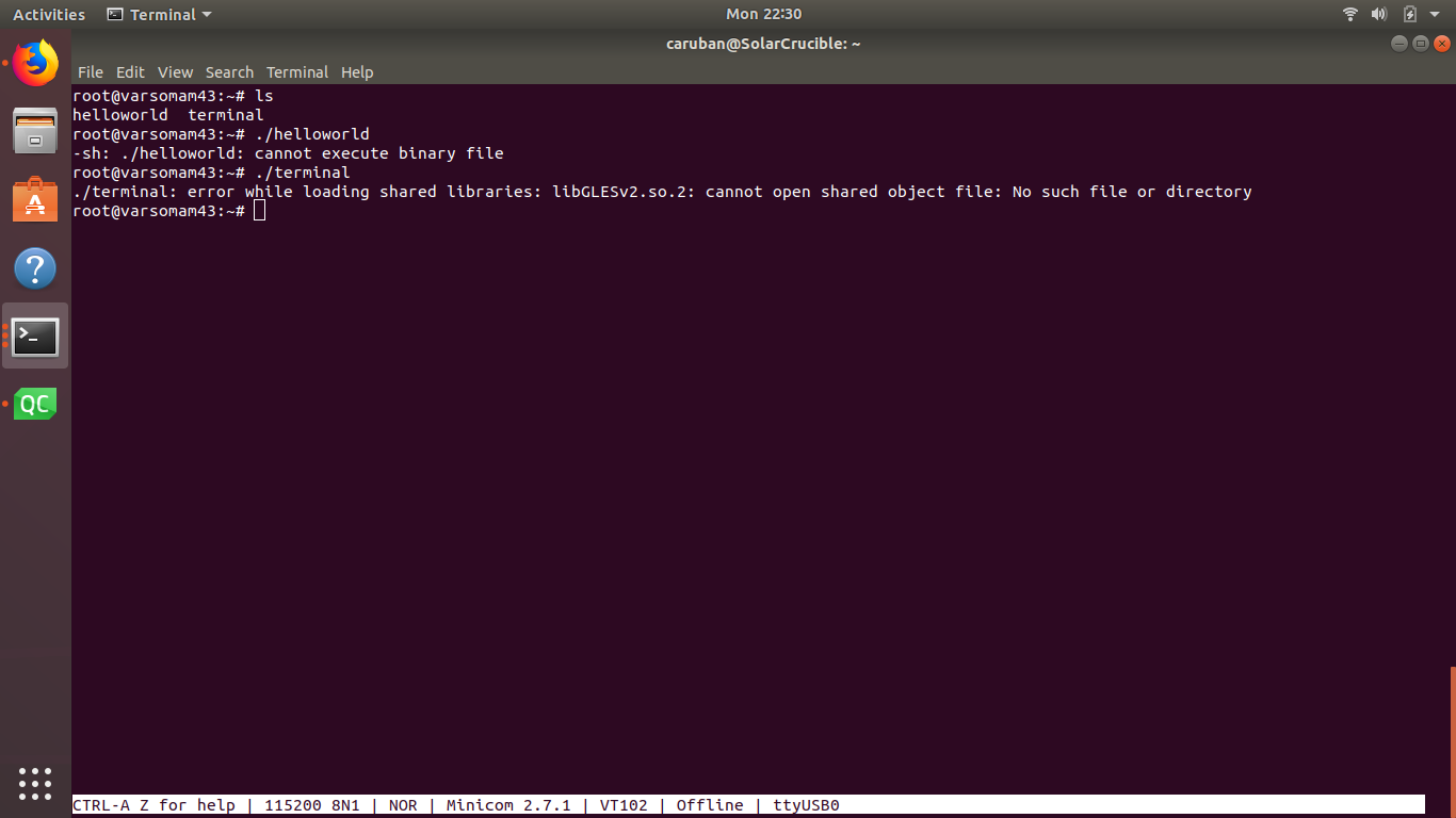

  • You are not running Processor SDK 6 on your board. Just create a new SD card with Processor SDK 6 and run your board with it.
  • Hi Kemal,
    Thank you for the quick reply. I have created an SD card with the create-sdcard.sh file in the SDK. After plugging it into the board's SD card slot and rebooting, The touchscreen has no display but I can confirm a successful boot through minicom. Since this is not an issue with Qt should I make a new thread about it?
    Kind regards,
    Shoaib
  • In addition to the touchscreen not displaying anything, these are the errors in Qt I have received after running:
  • Yes. The touch screen doesn't work in the Processor SKD 6. Please, switch to the previous Processor SDK 5.3.07 where it works, and do not forget to setup the Processor SDK 5.3.07 settings and paths in the Qt creator.
