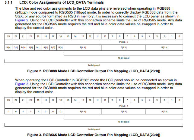

  Using am3354 Yocto processor-sdk-04.01.00.06 version interfaced with 18-bit lcd panel tft lcd display 800*480 resolution. display is not running smoothness, facing some gradient banding issues in RGB pixel color.
 So please help to resolve my issue.
Device tree paramters:

Referred ti forums, but I found this setup for lcd data pins
Configured 18 bit data lines in am335x board , but i have doubt about my setup. Anyone please verify & resolve my issue.
Render my images through Qt application & gradient colour dump , fb gradient application in git source, Even my display not running smoothness, some banding occurs .Please refer this link also https://e2e.ti.com/support/processors/f/791/p/806475/3047106#3047106
Is there an example of how to set up the AM335x for a 18 bit TFT?
