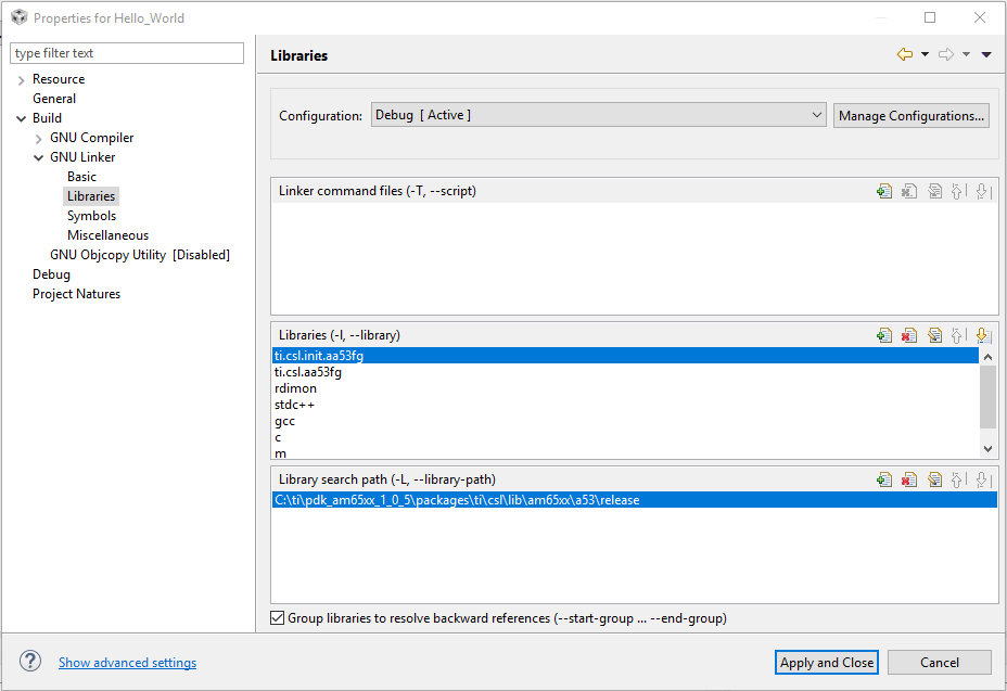

    Here is my GNU Linker Libraries config:
    I'll outline the different issues we're seeing below.

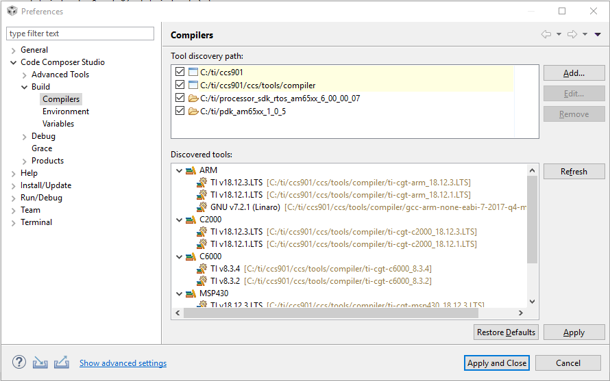

    Thanks for the suggestion! To clarify, the 9.9.2 instructions state we should be using the compiler version "GNU v7.2.1 (Linaro aarch64)", but only "GNU v7.2.1 (Linaro)" was available to me. Is this the core issue?
    I've looked through the documentation and don't see any instructions on how to detect the 64-bit compiler with CCS. I found this guide that explains how to add a compiler to CCS, but I can't find the 64-bit compiler in the RTOS SDK. Can you please point me to this?

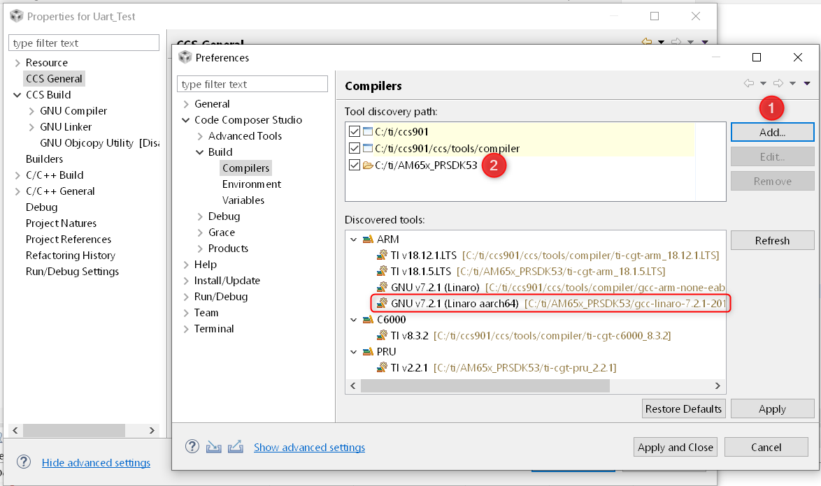

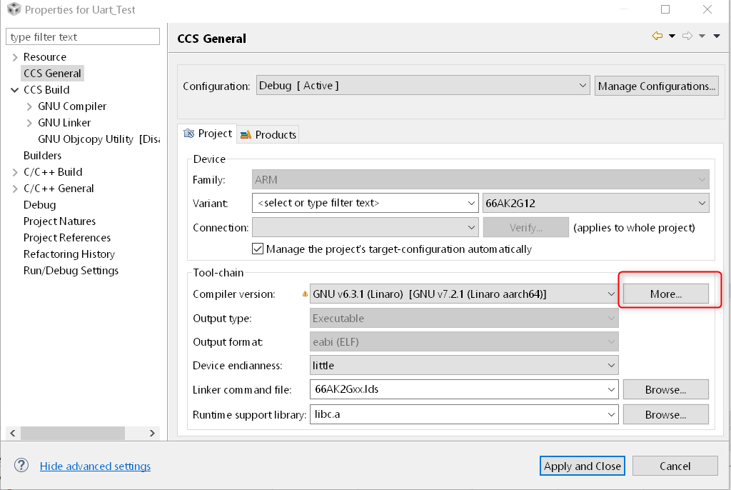

    to detect the 64 bit compiler, please open Project Properties and go to "More"
    Please try to rebuild with these settings. IF this is still something that doesn`t fix the issue, we can try to debug this based on the error log that you run into.

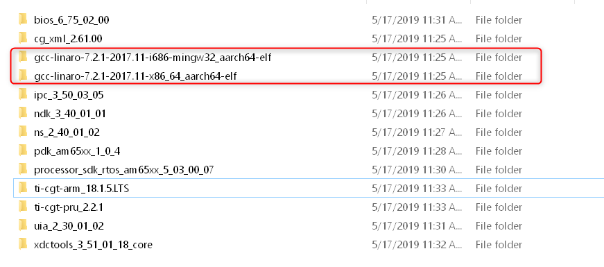

  • Update on this, the gcc-linaro directories were in C:\ti, under the names that Rahul had pointed out, but not in the RTOS SDK directory.
    Barend

    2 things the 64  bit files are not located under RTOS but under a higher directory (TI)
    and after that you need to add the path under CCS General --> more --> tool discover path...
