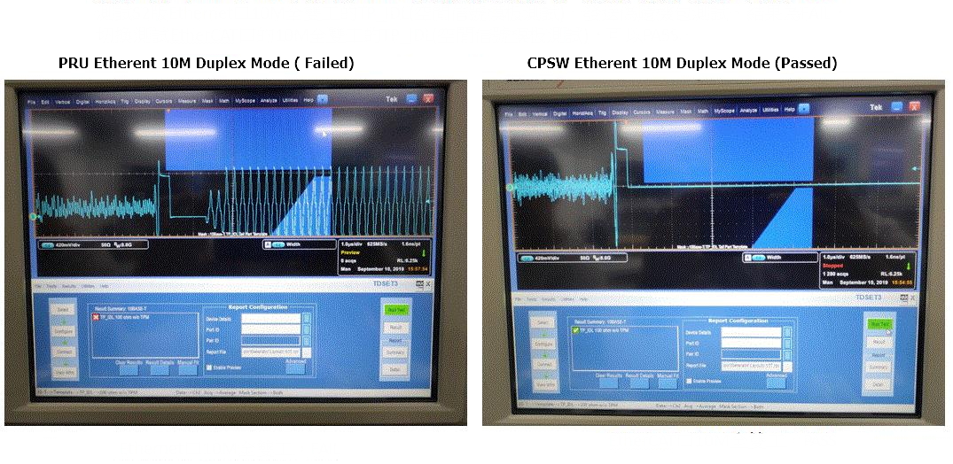

Hi SIr
We used AM4377 with SDK 4.03.00.05 for development.

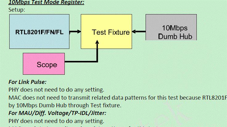

1. PRU MII is connected to  RTL8201 and CPSW RGMII is connected to RTL8211.
2. We have done the compliance test for Ethernet PHY.
We found we did the signal quality test failed in PRU Ethernet port
The duplicated is listed as below
1.Set AM4377 PRU Ethernet Port as 100M setting and CPSW Ethernet Port as 1000M setting.
2.We used  PRU Ethernet Port for 10M duplex test and send packet by using genpkt  command. It failed
3. We used CPSW Ethernet Port for 10M duplex test and send packet by using genpkt  command. It passed.
It seems this issue only happened in PRU Ethernet 10M mode.
Below is the information

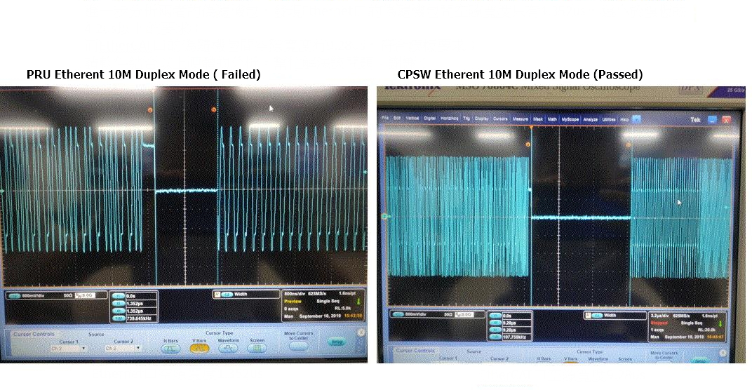

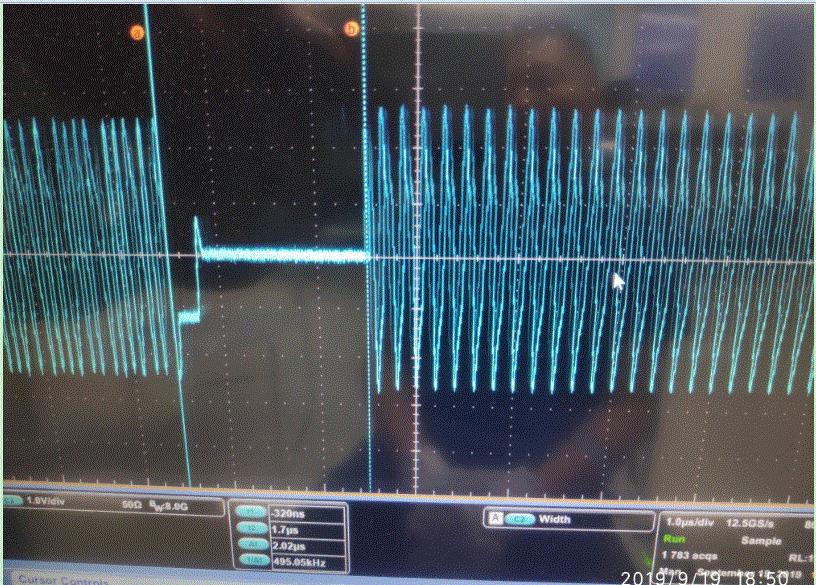

2. Below is the test waveform
    We found the PRU Ethernet Port test failed and cannot meet right photo requirement
     We found the signal from the PRU Ethernet Port has interference (Left Photo)
BTW, we found the inter-space width of left photo  is 1.325us. The standard spec should be over 4.2us.
The inter-space width of right photo is 9.28us
Please advise
BR
Yimin

  • Hi Sir
    1. This is the only test item for 10M mode. This test item called "TP_IDL Mask Test".
    2. We grab the signal from the output of the PHY chip.
    3. We don't have the EVM.
        but we have a My C437X-PRU board in hand.
        http://www.myirtech.com/list.asp?id=559
       The test result is also failed (the length is 2.02us). below is the signal photo
    BR
    Yimin
  • Hi SIr

    For context, are those MAC oscilloscope captures from a particular test?
    Nick
  • Hi Sir
        Those MAC oscilloscope captures are from Ethernet TPIDL Test failed item for PRU Ethernet Port.
    FYR
    Yimin
