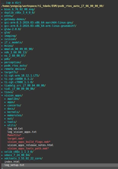

[TDA4M] Some errors when I do make vision_apps in psdk.
Other Parts Discussed in Thread: SYSBIOS
Hello.
I tried to build vision apps for Linux+TI-RTOS mode.
After editing the configuration files, build it. But it looks like there are several errors and fails.
I attached log file when I do "make vision_apps"
Check this file, and let me know why it's fail.

    I'll tell you what I did as below.
        1. Ran ProcessorSDK-RTOS-Automotive-06_00_00_00-linux-x64-installer.bin and installed it.
             - there was no problem.
        2. Copied tisdk-rootfs-image-j7-evm.tar.xz to {PSDKRA}/targetfs/ from {PSDALA}/filesystem/, and then unpacked it.
        3. Ran setup_psdk_rtos_auto.sh in {PSDK_DIR}/psdk_rtos_auto/scripts/
             - It seems like there was no problem. I attached a log file as well. -->

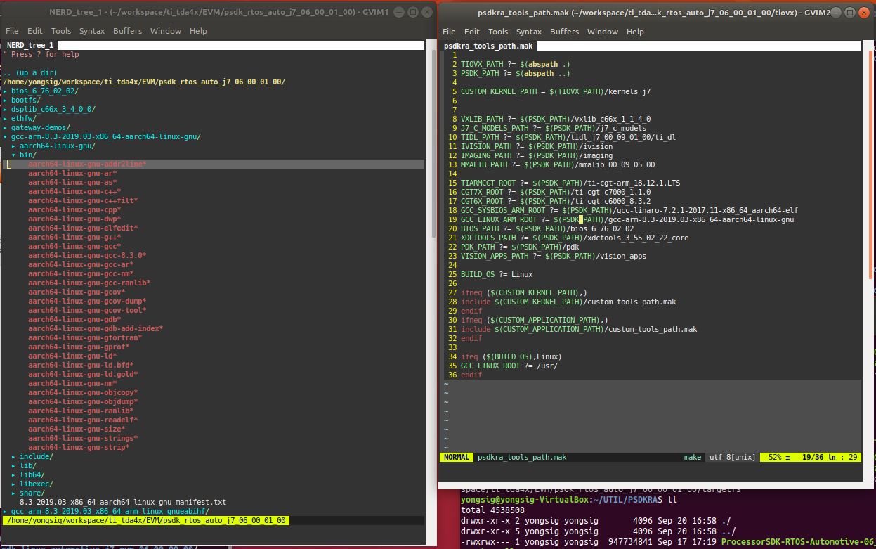

  • Hi Yongsig,
    The error that you are getting appears to be due to the fact that it cannot find the A72 SYSBIOS compiler.  Can you confirm that the gcc-linaro-7.2.1-2017.11-x86_64_aarch64-elf folder is found in the same directory that the vision apps folder that you are trying to compile?
    If so, could you confirm that the GCC_SYSBIOS_ARM_ROOT environment variable in tiovx/j7presi_tools_path.mak is pointing to the gcc-linaro-7.2.1-2017.11-x86_64_aarch64-elf folder and that this is not being overwritten in your environment?
    Lucas

    I checked directories but I couldn't find  the gcc-linaro-7.2.1-2017.11-x86_64_aarch64-elf folder.
       -- PSDKRA directories are as below.
    It seems like this folder is not installed when I ran setup_psdk_rtos_auto.sh.
    I'm sorry, I don't know why It's not installed.
    What should I do ?
    Best regards
    Yongsig

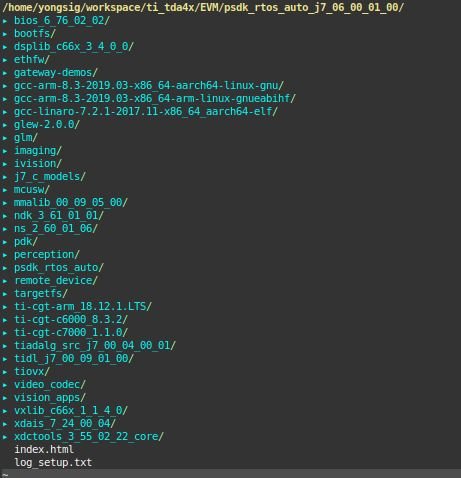

  • Hi, Lucas
    Today, I've upgraded the version of PSDKRA to 06.00.01.
    I tried the same sequence again, and I checked gcc-linaro was installed. But it seems like above problems wasn't solved.
    There are several fails still. Is it normal?
    I attachted several log files and hierarchy of directories as below.

  • Hi Kedar
    I think the gcc compiler is in the foler that you told me.
    I attached capture image. you can see that folder and tools_path.mak as below.
    Best regards
    Yongsig.
