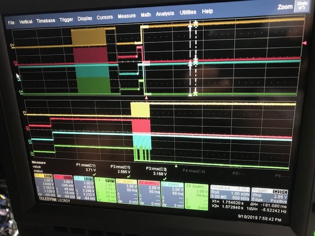

There are boot fail occurred in my customer's custom board at some time, and we found there was no progress in NAND communication when boot fail occurred.
When boot fail was occurred, booting was successful after reset or power recycling.
We have checked power rails, but could not find any issues in power rails, but found strange things in GMPC_D0 connected with NAND.
customer's boot mode is NAND boot mode(SYSBOOT[4:0] - 10011b)
When boot fail was occurred and checked GPMC_D0 using Oscilloscope, there was no more data communication with NAND after 1st communication as below.
Could you please let me know your idea how we can debug this issue further?
The NAND flash is Micron's MT29F1G08ABAEAWP.
In below picture :
Z1(yellow) - GPMC_D0,
Z2(red) - GPMC_ALE,
Z3(blue) - GPMC_WAIT0,
Z4(green) - GPMC_CLE
* normal case(booting success):
* boot fail:
The time duration are same between first high and low, and it is 164ms.

  • Please check the NAND R/B signal. It must be connected to GPMC_WAIT0 with external pullup.
  • Hi Biser,
    Yes. it is connected to GPMC_WAIT0 with external pullup.

  • Dear Team,
    One more thing I want to check with you.
    current boot mode is SYSBOOT[4:0] = 10011b(NAND->NANDI2C->MMC0->UART0).
    We changed boot mode to SYSBOOT[4:0] = 00010b(UART0->SPI0->NAND->NANDI2C) to check timing issue, and found 'CCC' in the UART0 and try 3rd boot of NAND and boot fail.
    I think there should be time-out and go to next bootmode when there was a communication issue with NAND or no response from NAND, but it seemed it was halt when NAND boot failed.
    If time-out occurred in NAND BOOT, I think there should be 'CCC' displayed through UART0 because UART0 is 4th BOOTMODE in current setting(10011b)
    Can you guess why time-out was not occurred in NAND boot?

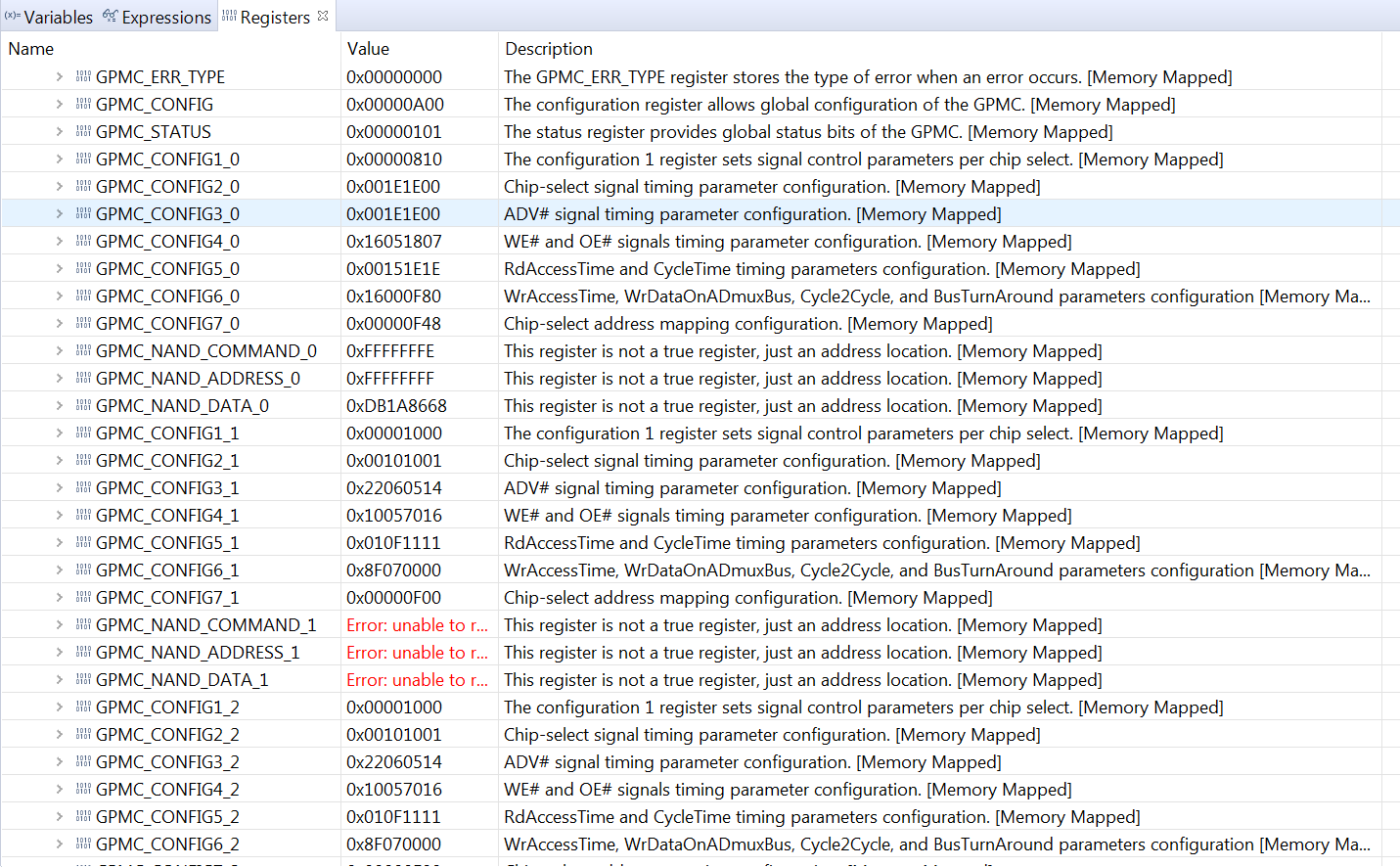

  • Dear Champs,
    Finally I succeed to connect JTAG and got below output when I run the am335x-boot.dss file Brad pointed to.
    1. Could you please provide details what it said?

  • Sung-IL said:
    it seemed the address PC was stopped is 0x402F35a8.
    Does this meant there was an issue in SPL, not RBL?
    The boot ROM appears to have loaded code and jumped to it.  I'm not sure yet if the issue is in SPL, as there are some other peculiarities in the output file you shared.  Here's an excerpt:

    4. If you look at the EMIF registers during a failed boot, does it look like they have been programmed?  If so, can you open up a memory window to address 0x80000000 and try poking in a few values (0x00c0ffee, 0xdeadbeef, etc.) and refresh several times to see if they stick?  Perhaps the most common early boot failure is DDR configuration issues.
    Brad

    And I captured register windows for EMIF as below.
    I added spinlock loop in the SPL and I connected JTAG at good boot(boot success), and found the disassembled instructions are not same at 0x402f35a8.
    And, I found the GPMC values were different between good boot and bad boot as below, but I need to check where my customer added spinlock loop.
    bad boot:
    good boot:
    I ran other dss files at bad boot(boot fail) and shared it in below.
    am335x-cttpadconf.zip

    Is it possible to check GPMC register values at bad boot?
    When I checked there was no difference in GPMC register between bad boot and good boot. NAND is Micron's 29F2G08ABAEA.
    I captured GPMC values in below at bad boot.
    Thanks and Best Regards,
    SI.
