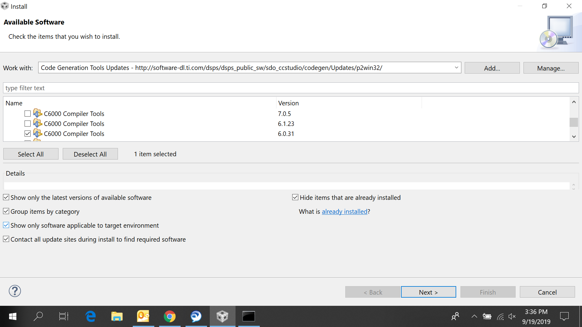

    While 6.0.11 counted as a production version at the time of its release, I do not recommend it now.  Instead, use version 6.0.31.  It is the same as all the other version 6.0.x compilers, but has more bugs fixed.  The only public way to obtain version 6.0.31 requires these steps.
    • Install the latest version of CCS (currently 9.1)
    • From within the latest CCS, select Help | Install Code Generation Tools.  Use the screen shot below as a guide
    • The compiler will then be installed in a location similar to: C:\ti\ccs910\ccs\tools\compiler\ti-cgt-c6000_6.0.31
    • Follow the directions above for adding the compiler to CCS 3.3
