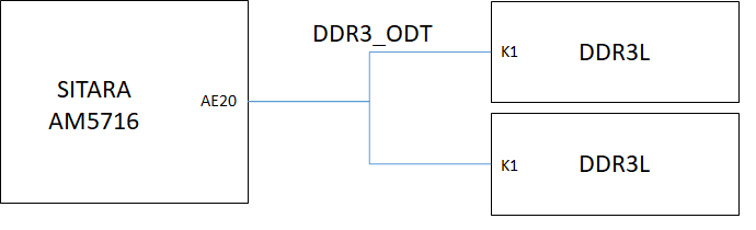

I'm going to start testing my new board with Sitara AM5716. It has two DDR3L (MT41K256M16TW).
Checking the schematics, I noticed that the net DDR3_ODT (see picture below) connects directly Sitara to the DDRs and I forgot to put a resistor (47ohm) from DDR3_ODT net and VDDR_VTT (0.675V).
Can I make it work without a rework on the board, i.e. without putting a 47ohm as required?
Thanks for your help!
