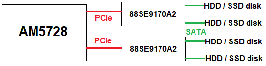

We designed a board with an AM5728 (Linux). Connected to its PCIe interface we have two Marvell 9170 (PCIe to 2xSATA converter), so that 4 drives can be connected to our board.
We are quite happy with the performance of the board. However we have a serious issue that prevents our product to go to the market.
The problem we  have is related to the identification of the drives at start time:
o If the board was previously shut down by software (from O.S: reboot, poweroff ….) the next power on is successful (all drives are detected and reads/writes to disks get no errors. Always)
o If the board was unexpectedly shut down (unplugging the power wire) there is a high possibility that in the next power on some drives (or even all of them) are not detected or generate errors at start time so that O.S. disables them.
We want to know what could cause this behavior. It seems a state is stored somewhere and depending on how it was previously closed, PICe powers on one way or another.
Do you have any hint about what could be causing this issue?
