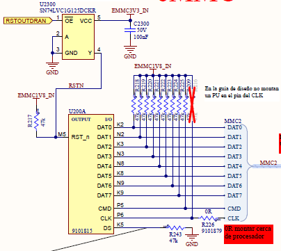

We are working on a custom board that includes a DRA76P with both QSPI and eMMC flash devices. QSPI P/N is S25FL256ASGMFV001 and eMMC is MTFC8GAMALNA-AAT.
QSPI is working fine. But not the eMMC memory. They are connected like shown:
We are able to flash it with no errors with fastboot.sh (included in the prebuild).

Any idea about what is happening?
Thank you very much!

    Can you check if data lines are routed correctly?
  • Also, check the below e2e link. Pull up resistors are recommended for data lines.
    https://e2e.ti.com/support/processors/f/791/t/839278
  • Hi Vishal,
    Yes, the PU resistor are in the data lines and in the cmd line (please, check the first post of this thread) but not in the clk line.
    I just measured the CLK line and I see a 400KHz clk, is this ok?

  • What TI SDK version are you using? our code base has covered for up to version 5.0.
    Could you generate Kernel logs with MMC_DEBUG enabled in Kernel defconfig? you may also have to change loglevel to 9 in Kernel (append loglevel=9 in kernel bootargs)
  • We are using SDK 3.02. I will add the traces support and send them to you.
  • We have added some traces to the kernel and we have arrive to the -110 error sorce. It comes from "mmc_wait_for_req_done" function in mmc/core/core.c
    It gets this error from the "wait_for_completion" call. There is no delay between we call the function and we get the error as response. We tried to use "wait_for_completion_timeout" with a timeout of 5000ms (wait_for_completion_timeout(&mrq->completion, msecs_to_jiffies(5000));) but also we get the same error.
    But the more strange thing it is that this error does not occur when you call "mmc_go_idle" funcion (when you send command 0). With this command you get no error, but with any other, you get -110
  • The MMC_DEBUG logs would provide information on what CMD were sent to emmc card and which CMD resulted in timeout error (-110).
    Another thing to check in dts is the mmc supply parameters.
    - vmmc-supply property should be set to Vdd voltage supply of the card
    - vmmc_aux-supply property should be set to Vio voltage supply for I/O lines
  • Hi Vishal,
    We have tried to update the dts changes you suggested (althouth it is not done that way for the EVM), and we get the same result.
    The CMD that are been sending are: 0x00, 0x05, 0x08, 0x05, 0x55, 0x55, 0x55 0x55. All of them but 0x00 returns -110 (timeout error). And 0x00 seems not to give timeout error because it is called with MMC_RSP_NONE flag option...
    We have painted the ios structure values, and all of them are similar but for "ios.vdd" that is 15 for the EVM and 7 for ours.
    Best regards.
  • Hi, is there any script to read eMMC with XDS probe? I'm talking about something like this: http://git.ti.com/sitara-dss-files/am57xx-dss-files/blobs/raw/master/am57xx-ddr.dss
  • Hi Roxu,
    Vdd value 0x15 implies 3.3 V,  I think 0x7 is for 1.65 to 1.95 volts.
    Vishal
  • Could you share the full Kernel log which has CONFIG_MMC enabled?
  • Dear Vishal,
    We followed your recomendations regarding the DTS files definitions, but still did not work. But we realized that maybe the regulators hadn't been well detected. And following this clue we found the root cause.
    We have defined the main input power line of the board "vsys_vbat", from where all the other rails hang, as to be controlled by driver "regulator-fixed". Then we defined the input voltage margins "regulator-min-microvolt=12000000" and "regulator-max-microvolt=30000000". And this does not work fine... The kernel was not detecting a good power chain and was not able to make the emmc work.
    We change both parameters to "regulator-min-microvolt=24000000" and "regulator-max-microvolt=24000000", and now it works fine. The regulators are detected an also it is able to boot form emmc.
    Thank you very much for your kind support.
    Best regards.
  • Thanks for the update. Glad it's resolved.
