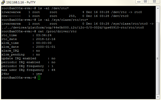

The system clock and rtc clock reading inconsistency, we rtc use the chip as dps65910,
6746.time_log.txt
The script detection time is 20min, the error is about 10 seconds, please help us to view.
root@am335x-evm:~# ls -al /dev/rtc*
root@am335x-evm:~# ls -al /sys/class/rtc/rtc*
root@am335x-evm:~# cat /proc/driver/rtc
How to overcome this issue ? Please provide me the guidance.

  • Tony,
    Please help me make sure I understand the issue. Is it that the RTC and the system time are drifting apart over time? Over the run the two drift by about 10 secs?
    This is the responsibility of the filesystem. In the SDK, we provide systemD that has a service to do this. Are they using the Arago filesystem?
    Basically, this is expected and there should be something in the system that synchronizes the two periodically.
    This can be done with something like systemD or something like a cron job.
    I hope this is helpful.

  • Hi Tony,
    I'm not sure about #1 above and i can't reproduce it. On my EVM, everything shows up correctly. The first thing I would recommend double checking would be the pinmux settings and compare those to the EVM via am335x-evm.dts.
    On #2, according to the bindings document for the PMIC, in /Documentation/devicetree/bindings/mfd/tps65910.txt, there is a "ti,en-ck32k-xtal" to enable the external crystal oscillator by default. There is also an example of how to add this.
    I hope enabling the external crystal improves things.

  • I agree with Ron's earlier suggestion of specifying ti,en-ck32k-xtal in the dts.  Given the severity of your inaccuracy, the most plausible explanation in my opinion is that the PMIC is configured to use the internal 32k clock rather than the external 32k clock.
  • We believe this issue is resolved by moving to the external crystal. Please let us know if you need additional support.
