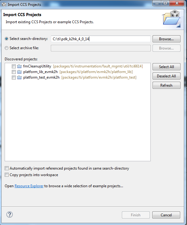

    5) I checked the created project as below :
    Finally, there isn't any project!!!
    What's wrong???

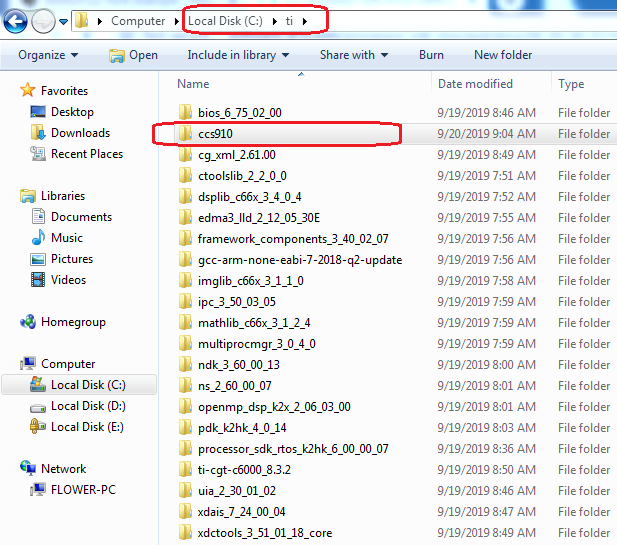

  • Dear Yordan
    The CCS and SDK are installed in the same folder as below:
  • Hi
    I can solve the problem, in "pdkProjectCreate.bat" file at line 449, I modified the CCS version from CCS901 to CCS910 and the problem solved.
