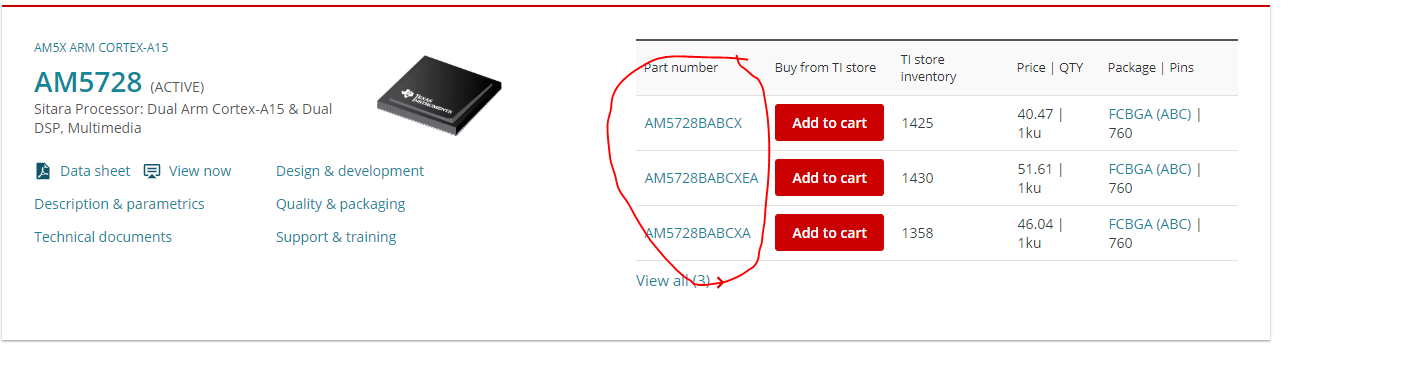

My board is TMDXIDK572 ,the AM5728 is XAM5728BABCXE
I want to use the same 5728 in this board
I find three different Part number about 5728
now which one should I select ?
You will find the device naming convention in section 9.1.2 of the AM572X Datasheet SR2.0 Rev. F.
Please read the device naming convention in section 9.1.2 of the AM572X Datasheet SR2.0 Rev. F. You will probably not find XAM devices on the market. "X" means that this is an experimental device that is not necessarily representative of the final device's electrical specifications and may not use production assembly flow. You should choose one of the available devices depending on your requirements for industrial protocols and temperature range.
now the am5728 in my boad is broken,so I want buy a new one .
so I can buy AM5728BABCXEA to replace the broken one?
