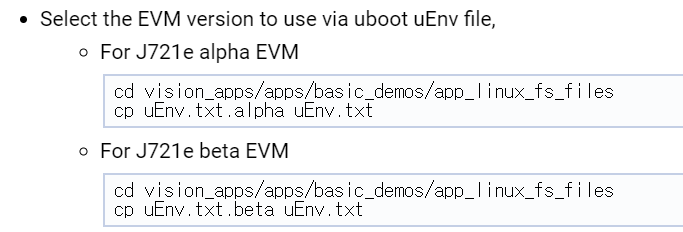

I'm preparing SD card with PSDK 06.00.01
How can I find out my EVM is alpha or beta for copying appropriate uEnv.txt?

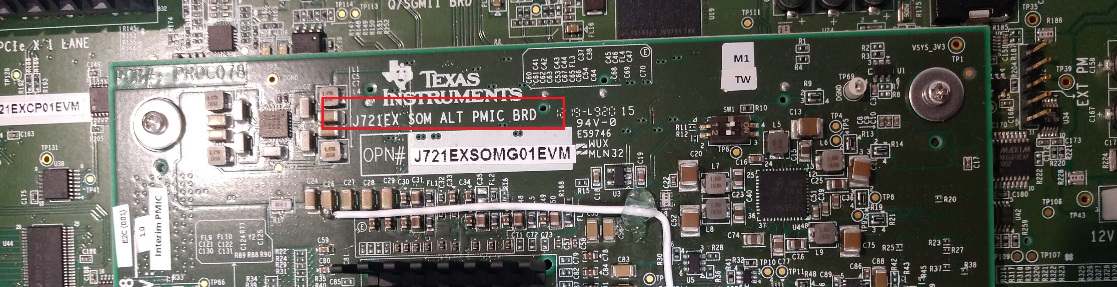

  • One way to find out is based on the text printed on the processor board (location above the heat sink),
    • For J7 Alpha EVM, the processor board would be labelled "J721Ex SOM ALT PMIC BRD"
    • For J7 Beta EVM, the processor board would be labelled "J721EX SOM 941x PMIC BRD"
