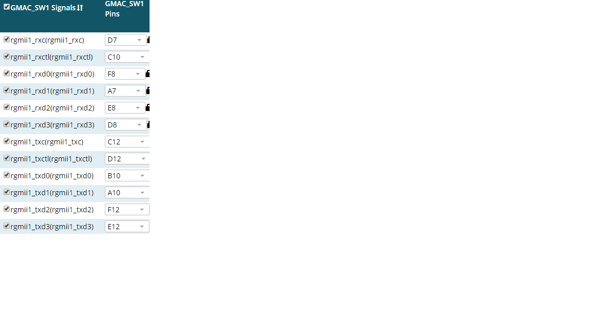

Hi Sir,
Our project is based DRA78x, the SDK is ti-processor-sdk-rtos-automotive-dra7xx-evm-04.03.00.05.
We use RGMII1 to connect ethernet,the pin mux is as below,I find nimu is only for RGMII0,could you give any suggestions?
    The Ethernet works with RGMII0 (on TDA3 EVM).
    Customer's hardware is using RGMII1 due to the conflict of SD/MMC and RGMII0 (compared with TI TDA3 EVM).
    Please kindly guide us on how to make it work (RGMII1) on customer's hardware.
    Many thanks.
    Once the desired pinmux settings for RMGII1 have been determined by the pinmux tool (i.e. your screenshot indicates you are using the pinmux tool), the pinmux settings will need to be changed in the PinmuxRgmiiConfig() function within the <PDK>/packages/ti/board/src/evmDRA78x/evmDRA78x.c to instead set up the pin muxing for RGMII1.

    A common scenario where you are not able to ping from the PC to the target is incorrect pin muxing for the RGMII1.  Can you confirm your pin muxing is correct?
    Your log seems to indicate that the Phy is likely powered up correctly now.  Can you share the values of the pin mux registers?
                  Danny
  • Hi, Danny:
    Here is the dump:
    0x4A00 3408      CTRL_CORE_PAD_GPMC_BEN1      rgmii1_txd3      0x00000001
    0x4A00 3434      CTRL_CORE_PAD_GPMC_WAIT0     rgmii1_rxd3     0x00040001
    0x4A00 3438      CTRL_CORE_PAD_GPMC_AD0        rgmii1_rxd2      0x00040001
    0x4A00 343C     CTRL_CORE_PAD_GPMC_AD1         rgmii1_rxd1     0x00040001
    0x4A00 3440      CTRL_CORE_PAD_GPMC_AD2        rgmii1_rxd0      0x00040001
    0x4A00 346C     CTRL_CORE_PAD_GPMC_AD13      rgmii1_rxc         0x00040001
    0x4A00 3418      CTRL_CORE_PAD_GPMC_CS0       rgmii1_rxctl       0x00040001
    0x4A00 340C      CTRL_CORE_PAD_GPMC_ADVN_ALE     rgmii1_txd2       0x00000001
    0x4A00 3410       CTRL_CORE_PAD_GPMC_OEN_REN      rgmii1_txd1       0x00000001
    0x4A00 3414       CTRL_CORE_PAD_GPMC_WEN               rgmii1_txd0       0x00000001
    0x4A00 3400       CTRL_CORE_PAD_GPMC_CLK                rgmii1_txc         0x00000001
    0x4A00 3404       CTRL_CORE_PAD_GPMC_BEN0              rgmii1_txctl       0x00000001
    I think the pinmux is correct.
