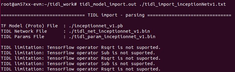

I tried to convert to "inceptionnet_v1.pb" based on the E2E-thread with below environment.
   - SDK: ti-processor-sdk-linux-am57xx-evm-06.00.00.07
   - EVM: TMDSEVM572X
But it seems to fail with errors like below;
Here is detail:
   > activate tf1.1_env
   Download from https://github.com/tensorflow/models
   >cd inception\inception
   >python freeze_inception_net_v1.py ( copy from python_freeze_graph.zip )
   (copy from ..Lib\site-packages\tensorflow\python\tools\optimize_for_inference.py )
   >python optimize_for_inference.py --input=inception_v1.pb --output=inceptionnet_v1.pb --input_names=input --output_name=softmax/Softmax
Then, convert to tidl files on TMDSEVM572X
evm> tidl_model_import.out.exe tidl_import_inceptionNetv1.txt

  • Matusan,
    I have found a similar result on my machine. The TIDL library does not support those operations (this is documented in the link below - section 3.15.2.1).
    http://software-dl.ti.com/processor-sdk-linux/esd/docs/latest/linux/Foundational_Components_TIDL.html#developer-s-guide
    You will need to work around using NN operations by using an L1 norm layer instead of an L2 (L2's require square root operations) and by eliminating the need for subtractions.
    Caleb
