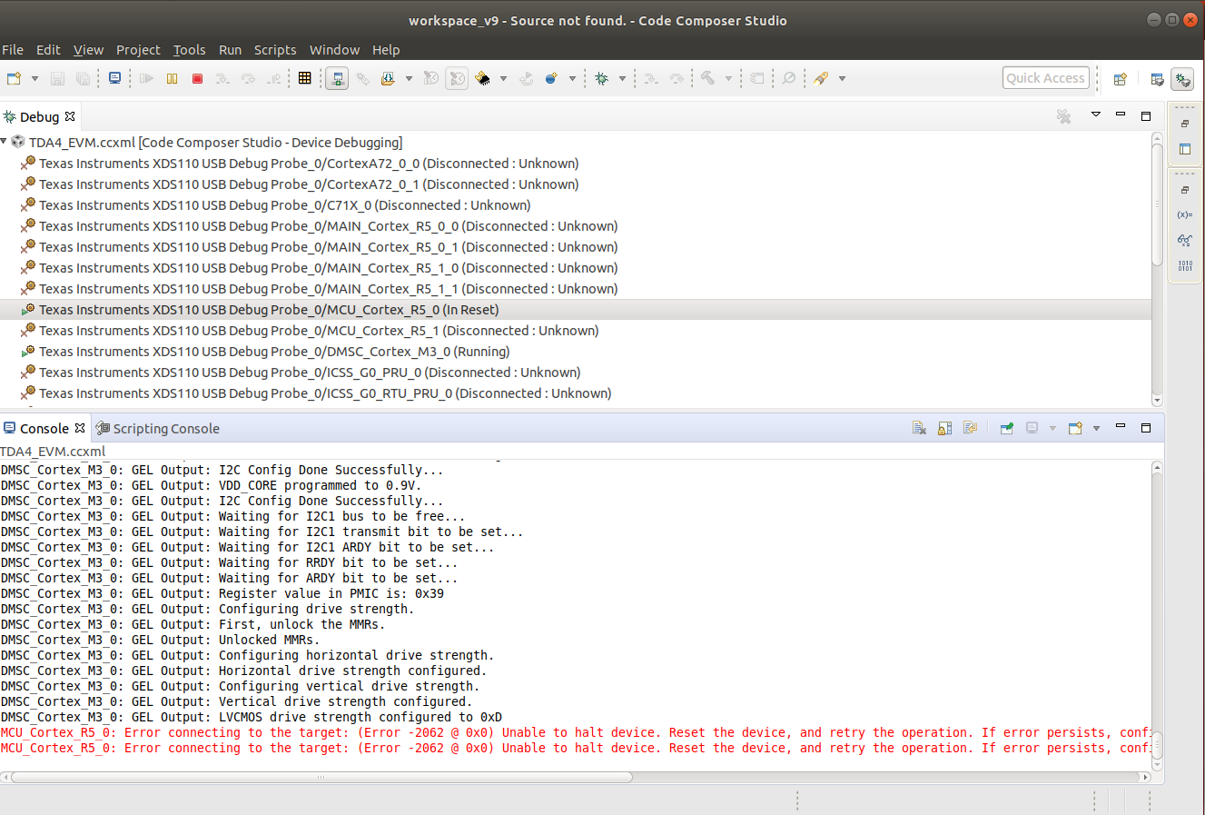

We are planning to do some example check using CCS on TDA4 EVM board.
I follow the CCS Setup steps in "Processor SDK RTOS Automotive User Guide".
When I do the action in step 4, execute the load command in the scripting console.
It always failed and stuck at  Running the board configuration initialization from R5!
The error message is :
Error loading "/home/tda4dev/psdk_rtos_auto_j7_06_00_00_00/pdk/packages/ti/drv/sciclient/tools/ccsLoadDmsc/j721e/sciclient_ccs_init_mcu1_0_release.xer5f": Timed out after 20000ms while waiting for target to halt after an auto-run to "main (/home/tda4dev/psdk_rtos_auto_j7_06_00_00_00/pdk/packages/ti/drv/sciclient/tools/ccsLoadDmsc/j721e/launch.js#125) (/home/tda4dev/psdk_rtos_auto_j7_06_00_00_00/pdk/packages/ti/drv/sciclient/tools/ccsLoadDmsc/j721e/launch.js#125)
Is there some step missing in this user guide ?
I tried the CCS Setup steps in linux and windows environment and got the same error.
Windows 10 Professional 64 bit, Code Composer Studio version 9.1.0.00010
Ubuntu 18.04 64 bit, Code Composer Studio version 9.1.0.00010

  • Hi Rishabh,
    Yes, I edited the path of pdkPathccs_init_elf_file and sysfw_bin in file launch.js.
    The messages in the scripting console window:
    Initializing .. (Completed)
    js:> load("/home/tda4dev/psdk_rtos_auto_j7_06_00_00_00/pdk/packages/ti/drv/sciclient/tools/ccsLoadDmsc/j721e/launch.js");
    Connecting to DMSC_Cortex_M3_0!
    Loading DMSC Firmware ... /home/tda4dev/psdk_rtos_auto_j7_06_00_00_00/pdk/packages/ti/drv/sciclient/soc/V1/ti-sci-firmware-j721e-gp.bin
    DMSC Firmware Load Done...
    DMSC Firmware run starting now...
    Connecting to MCU Cortex_R5_0!
    js:>
    And the status of MCU_Cortex_R5_0 and DMSC_COrtex_M3_0 are keeping to Running
    Can you share updated launch.js

    It seems that Gel files are not getting loaded through ccxml.
    Can you please share a screenshot of CCS when this error occurs.
    Rishabh

  • Hi Kenny,
    I want to see the Console instead of Scripting Console.
    Yes you are correct, you have to use the gel file from the folder "ti/ccs910/ccs_base/emulation/boards/dra8x/gel".
    Rishabh
  • The full messages in Console window are as below:

    DMSC_Cortex_M3_0: GEL Output: Powering up LPSC_CSIRX_1
    DMSC_Cortex_M3_0: GEL Output: Power domain and module state changed successfully.
    DMSC_Cortex_M3_0: GEL Output: Powering up LPSC_CSIRX_2
    DMSC_Cortex_M3_0: GEL Output: Powering up LPSC_C71X_0
    DMSC_Cortex_M3_0: GEL Output: No change needed.
    DMSC_Cortex_M3_0: GEL Output: Powering up LPSC_C71X_1
    DMSC_Cortex_M3_0: GEL Output: Powering up LPSC_C71X_0_PBIST
    DMSC_Cortex_M3_0: GEL Output: Powering up LPSC_C71X_1_PBIST

    DMSC_Cortex_M3_0: GEL Output: Powering up all PSC power domains done!
    DMSC_Cortex_M3_0: GEL Output: WKUP/MCU clock selection and Pad configuration MMRs unlocked.
    DMSC_Cortex_M3_0: GEL Output: I2C Config Done Successfully...
    DMSC_Cortex_M3_0: GEL Output: VDD_CORE programmed to 0.9V.
    DMSC_Cortex_M3_0: GEL Output: Waiting for I2C1 bus to be free...
    DMSC_Cortex_M3_0: GEL Output: Waiting for I2C1 transmit bit to be set...
    DMSC_Cortex_M3_0: GEL Output: Waiting for I2C1 ARDY bit to be set...
    DMSC_Cortex_M3_0: GEL Output: Waiting for RRDY bit to be set...
    DMSC_Cortex_M3_0: GEL Output: Waiting for ARDY bit to be set...
    DMSC_Cortex_M3_0: GEL Output: Register value in PMIC is: 0x39
    DMSC_Cortex_M3_0: GEL Output: Configuring drive strength.
    DMSC_Cortex_M3_0: GEL Output: First, unlock the MMRs.
    DMSC_Cortex_M3_0: GEL Output: Unlocked MMRs.
    DMSC_Cortex_M3_0: GEL Output: Configuring horizontal drive strength.
    DMSC_Cortex_M3_0: GEL Output: Horizontal drive strength configured.
    DMSC_Cortex_M3_0: GEL Output: Configuring vertical drive strength.
    DMSC_Cortex_M3_0: GEL Output: Vertical drive strength configured.
    DMSC_Cortex_M3_0: GEL Output: LVCMOS drive strength configured to 0xD
    MCU_Cortex_R5_0: Error connecting to the target: (Error -2062 @ 0x0) Unable to halt device. Reset the device, and retry the operation. If error persists, confirm configuration, power-cycle the board, and/or try more reliable JTAG settings (e.g. lower TCLK). (Emulation package 8.2.2.47)
    Have you set the board to "NO BOOT" mode?
    Rishabh
    sadly I seem to have the same problem here.
    For me it hangs at GEL Expression: OnTargetConnect().
    Than it hangs. When canceling and retrying to launch the js file it gets over this point but hangs later.
    The scripting console shows:
    js:> load("/home/REMOVED/psdk_rtos_auto_j7_06_00_01_00/pdk/packages/ti/drv/sciclient/tools/ccsLoadDmsc/j721e/launch.js")
    Error connecting to the target: Timed out after 200000ms (/home/REMOVED/psdk_rtos_auto_j7_06_00_01_00/pdk/packages/ti/drv/sciclient/tools/ccsLoadDmsc/j721e/launch.js#105) (/home/REMOVED/psdk_rtos_auto_j7_06_00_01_00/pdk/packages/ti/drv/sciclient/tools/ccsLoadDmsc/j721e/launch.js#105)
    Loading DMSC Firmware ... /home/REMOVED/psdk_rtos_auto_j7_06_00_01_00/pdk/packages/ti/drv/sciclient/soc/V1/ti-sci-firmware-j721e-gp.bin
    And the console shows:
    [MCU_Cortex_R5_0]
    DMSC Board Configuration with Debug enable
     DMSC Firmware Version 19.6.1-v2019.06a-1-gb5a4f (Terr
     Firmware revision 0x13
     ABI revision 2.6
    Now I don't know, is this OK?
    When select "connect to target" on the C77 I get an error:
    (Error -2081 - (0:0:0))
    Device functional clock appears to be off. Power-cycle the board. If error persists, confirm configuration and/or try more reliable JTAG settings (e.g. lower TCLK).
    Best regards
    Jan
  • Hi Jan,
    This error usually occurs when board is set in a particular boot mode.
    Have you set the board to NO BOOT mode?
    Rishabh

    Can you try commenting below piece of code from gel files:
    //Configure the PMIC voltage rail for VDD_Core to 0.9V to support LPDDR4 at 4266MT/s.
    //First, unlock the WKUP/MCU domain Padconfig MMRs.
    unlockWkupPads();
    GEL_TextOut("WKUP/MCU clock selection and Pad configuration MMRs unlocked.\n");
    //Configure the I2C bus, and write to the PMIC to set the output voltage for VDD_CORE to 0.9V.
    Configure_Core_0v9();
    GEL_TextOut("VDD_CORE programmed to 0.9V.\n");
    //Check the configuration by reading back the values written to PMC.
    temp = Read_VDD_Core_Config();
    GEL_TextOut("Register value in PMIC is: %x\n",,,,, temp);
    Rishabh

  • I managed to get to the point where the console tells "happy debugging", so this works.
    When I debug a C66 project I get the following:
    C66xx_0: Error connecting to the target: (Error -1143 @ 0x0) Device core was hung. The debugger has forced the device to a ready state and recovered debug control, but your application's state is now corrupt. You should have limited access to memory and registers, but you may need to reset the device to debug further. (Emulation package 8.2.2.47)
    C66xx_0: Trouble Writing Memory Block at 0xc000000 on Page 0 of Length 0x7ff0: (Error -1060 @ 0xC000000) Device is not responding to the request. Reset the device, and retry the operation. If error persists, confirm configuration, power-cycle the board, and/or try more reliable JTAG settings (e.g. lower TCLK). (Emulation package 8.2.2.47)
    C66xx_0: File Loader: Verification failed: Target failed to write 0x0C000000
    C66xx_0: GEL: File: /home/IBEO.AS/jahi/perception-benchmarking-suite/CCS_workspace/BenchmarkMAC_C66/Debug/BenchmarkMAC_C66.out: Load failed.
    Another question: How to I know the exact model of DSP in the SOC? Like TMS320C66xx.
    I guess I am using the wrong linker script. Maybe it is not yet contained in the CCS. Is there an example for the C66 and especially for the C7 DSP?
    Best regards
    Jan
