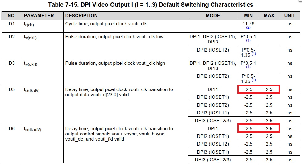

For the Delay time between output signals, both minimum and maximum times are defined and the range between these times is very wide. For example, they are defined for VOUT1 as follows:
Why is the range between the minimum and maximum times very wide?
Does it mean that the Delay time is calibrated in the range between the minimum and maximum times by the IO Delay Recalibration?

    It is normal to see a range for timing parameters to account for process, temperature, and voltage variations.
    The IO Timings provided  are only valid for some DSS usage modes when the corresponding Virtual IO Timings or Manual IO Timings are configured as described in the table.
    Be sure to read the notes and cautions at the beginning of section 7.7

  • Hi Paul-san,
    Thank you for your reply.
    I understand that it is normal range.
