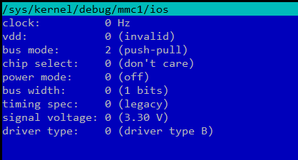

I'm trying to connect an SD card to the MMC3 on the Beaglebone black. I created a custom board with an SD card holder. I've written a device tree overlay (I'm still learning it) to enable this peripheral.
In /sys/class I can see the MMC3 as MMC1 with the correct parameters. However under /dev I can't see the SD card. Furthermore under /sys/kernel/debug/mmc1/ios I get strange values, for example the VDD is 0 (invalid), the clock is 0Hz etc. (See the attached image)
And here is my complete device tree overlay:

    Thanks for the answer. This is the output of uname -a:
    Linux beaglebone 4.14.71-ti-r80 #1 SMP PREEMPT Fri Oct 5 23:50:11 UTC 2018 armv7l GNU/Linux
    I forgot to say that I use u-boot overlays, so I added my custom.dtb as a cape in uEnv.txt. You can see that there is an i2c device (RTC) which is detected if I enable this overlay. In the meantime I added some GPIO-s as well (I disabled the universal cape in uEnv.txt) and it works.
    Only the MMC2 not. I tried to make errors in the MMC overlay to see if the kernel actually loads the driver or not. Any error in the overlay is detected. So I assume that this configuration is okay. But unfortunately it doesn't work.
