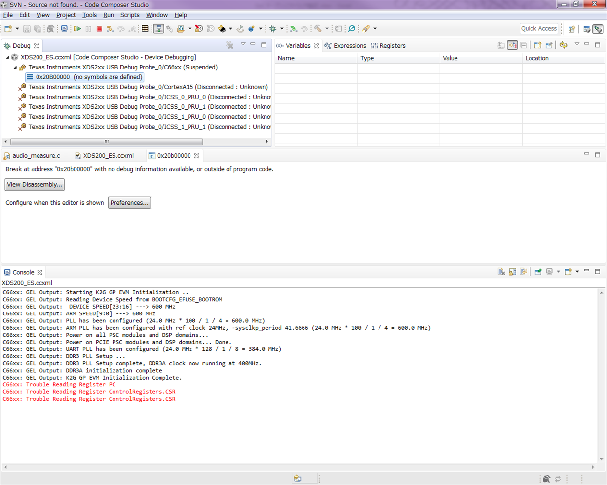

We are developing our product used 66AK2G.
Currently, we are debugging using XDS200 with CCS(code composer studio).
But there is something troudble, So please check the text coloed red in the console, We want to know about below.
1. Is the ControlRegisters.CSR equal to control status register?  1. Is the PC equal to program counter?
2. What mean is trouble reading?(communication error?)
3. what dose the cause happen this trouble?

    I suspect this is more likely to be wrong initialization of your board. I see you use custom board and the 66AK2G12 GP EVM gel file. Have you modified the gel file to match your board (PLL initialization, DDR settings, etc...)?  I suggest using the ddr spreadsheet to check your ddr settigns: also check the following document:
    Also make sure you correctly set up your PLL.

  • Dear Yordan,
    Thank you for advise.
    Is the our below recognition right?
    「The Trouble Reading of ControlRegisters.CSR is caused by that can not read the control status register value from DDR3.」
    If our this is right, we will check about the hardware of DDR3 and gel setting of DDR3 more detail.
    Best regards.
    No, I didn't meant that. My concern is mainly initializing the SoC: correct pll settings, see evmk2g_arm.gel & evmk2g.gel. Communication with DDR3 is essential for further operation of your board (loading a program on a specific core and executing it).

  • Dear Yordan,
    Thank you for your support.
    The DDR3 issue may be resloved.
