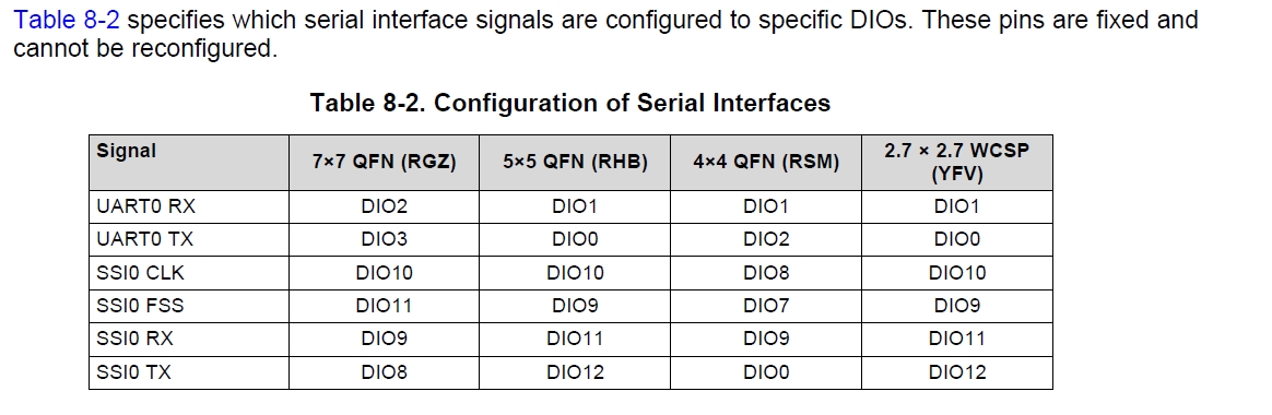

We are noticing a ~1us wide strong negative pulse about 1ms after reset completes (Logic L->H transition).  this is causing a problem with an external watchdog device.  Is there a way to suppress this?  this isn't a "glitch as it is clear the I/O cell is acting a totem-pole output and strongly pulling down (we tried a 1K pull up and the signal was still there).
We are assuming this is some type of "auto-detect" for some port.  Can this be inhibited?  This is before our code is even installed.

  • Hi Mark,
    Bootloader uses the pin (DIO10) as part of SSI bus until it get a valid image. Please see the following table.
    Please refer to section 8.2.2 of TRM for more details.

    No, it checks both UART and SSI buses until it gets the image from one of those interface. Please see the following text form the TRM.
    "The bootloader selects the interface that is the first to be accessed by the external device. Once selected,
    the TX output pin for the selected interface is configured; the module on the inactive interface (UART0 or
    SSI0) is disabled. To switch to the other interface, the CC26x0 and CC13x0 devices must be reset."

  • We didn't "select" an interface yet (by transmitting data at it). All the other SSIO pins have nothing connected to them.  Is just having a pull-up causing the problem, or is the chip going to "test" that I/O line (DIO_10) no mater what?  The pull-up is there during the RESET time so there is NO activity on the DIO_10 line from our circuitry.
    -Mark W
    It monitors both SSI and UART interfaces until it gets the valid Image. Until that you can't use that interface.
