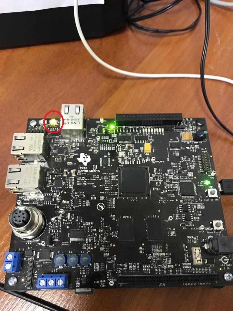

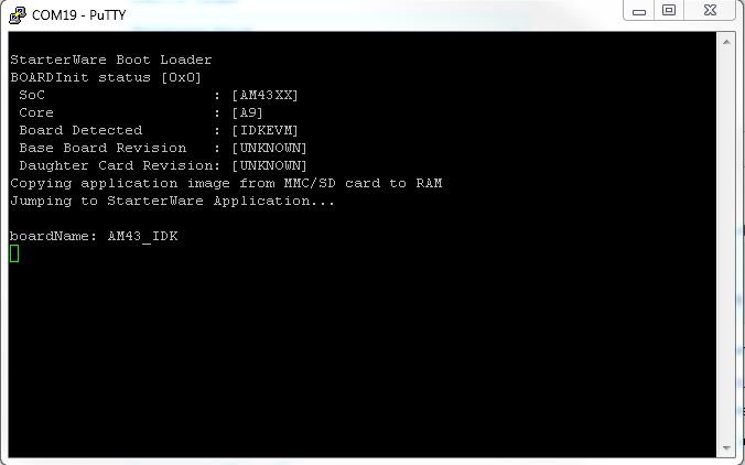

5. Set the SD to the slot on the IDK board. Connected the console. And I saw the following.
Two U2 LEDs on the board light up.
What did I do wrong?
Or didn’t I finish it?
What else should I try to do?
