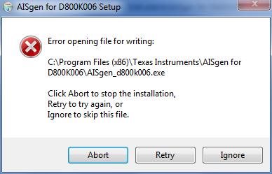

I am trying to instal AISGen fro sprab41.zip but get the following error window:
Can someone give me a hand interpreting this?

  • Mike,
    Does your PC run 64-bit Windows?  If so, you may want to try running the installer by right-clicking it and selecting "run as administrator."
    Let me know if that helps.
  • Joe,
    Yes, that allowed me to install the app. However, now I am getting the following unhandled exception:

  • Figured it out. Had to set pgm to run as admin for everyone.
