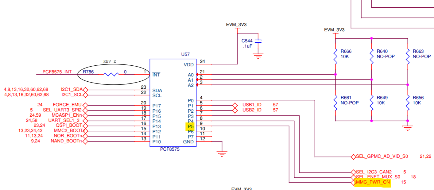

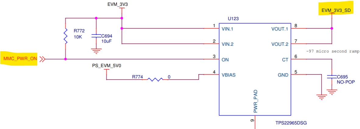

  • Hi Terence,
    -1-
    On TI EVM, we have a GPIO that controls the power switch to turn on EVM_3V3_SD, and that's why we have the below GPIO entry in our kernel.
    Based on your board design this may not apply, so it's ok to skip this.
    gpio=<&pcf_gpio_21 5 GPIO_ACTIVE_HIGH>;
    -2-
    Based on your board design if you need this regulator to be on all the time.  You have to set the 'regulator-always-on' property.
    For more information on regulator properties of dts, refer to file Documentation/devicetree/bindings/regulator/regulator.txt in Kernel
    Vishal
