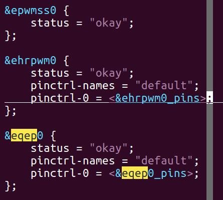

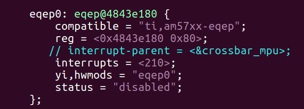

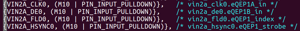

1、certify pin multiple
2、arch/arm/boot/dts/dra7.dtsi   add  eqep0  node
Add the following to our own device tree
3、Add the tieqep.c file in /driver/misc and compile the build module
