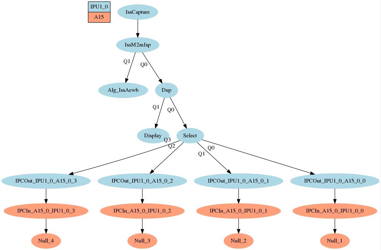

  • Hi, Nikhil,
    The use case is intended to capture video contents from 4 cameras and to store the contents on four SSDs. This use case itself does not perform shutdown command. The use case gets started by running the "apps.out" executable and gets stopped by entering "0" key. The use case performs and stops correctly. Also, the "apps.out" binary gets stopped.
    After "apps.out" gets stopped, the shutdown command can be invoked from command line, as I have mentioned within my first post in this thread. Namely, I run the following command from the command line: "shutdown -h -P now".
    At the end of the log, after the aforementioned shutdown command gets run, I get the "Kernel panic" log as described within my first post.
    The dataflow diagram corresponding to the use case I run is given as an attachment.
    The links marked with red color run on Linux OS, on A15 core.
    I am interested whether there is any way to allocate some additional memory regions that can be used for "in-place" processing operations, so as those regions can be shared between two or more links, since I face the "Kernel panic" issue when I attempt to use more than 189MB on SR1.
    Marko Gostović
