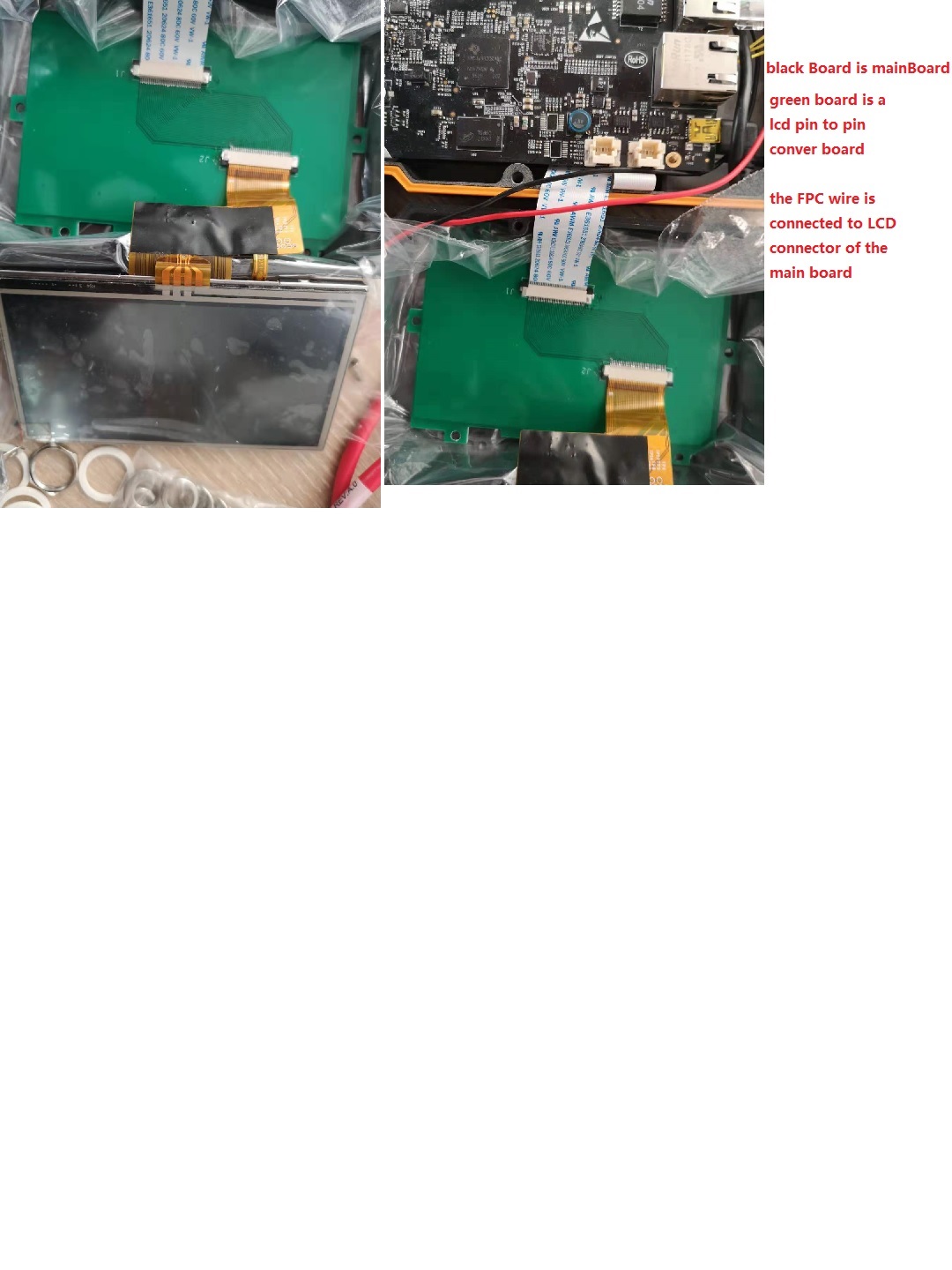

Hi ,
I am using am3359 evmsk , linux version is linux-4.14.67.
I am debugging the touchscreen, it is resistive screen .I clicked on the screen and there was no response.
so I run weston-calibrator and return the next message:
could not load cursor 'dnd-move'
could not load cursor 'dnd-copy'
could not load cursor 'dnd-none'
Calibration values: 96.500000 160000.500000 -37160164.000000 -12.500000 -121.000000 33501.500000
but I am not click the touchscreen.
Then I test with evtest, and select /dev/input/event1: ti-tsc
The console continues to print the following information, and I did not click on the touch screen.

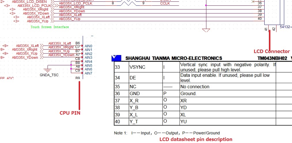

the setting of dts file as follows:
&tscadc {
status = "okay";
tsc {
ti,wires = <4>;
ti,x-plate-resistance = <200>;
ti,coordinate-readouts = <5>;
ti,wire-config = <0x00 0x11 0x22 0x33>;
ti,charge-delay = <0x400>;
So what is wrong with my board?
Thank you.
