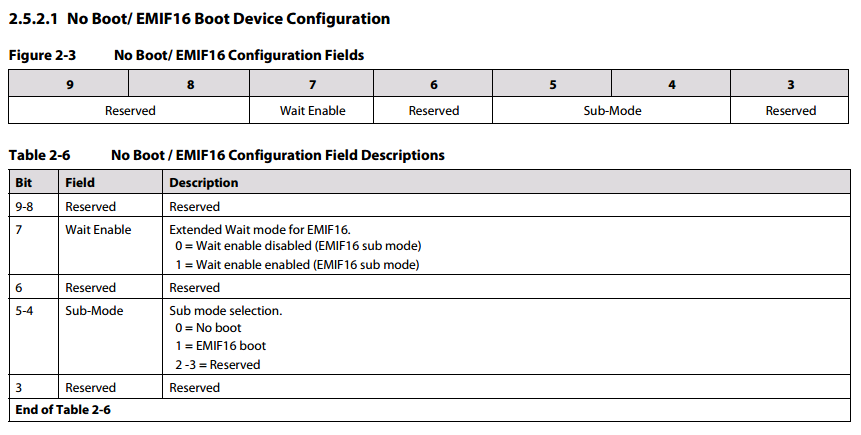

DSP: TMS320C6678CYP YB20-84ZCLL9 2010 TI 2 CYP G1
Boot mode:EMIF Nor Flash Boot
Version 2012:
The latest version:
Which should be referred to? Is it related to silicon version?
Version 2012:
The latest version:
Hi Nancy,
You should refer to the latest revision of the documents. They are not related to silicon revision. If there are bugs or the device operation for a particular silicon revision deviates from what's described in the documentations, it should be mentioned in the Silicon Errata document.
