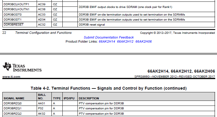

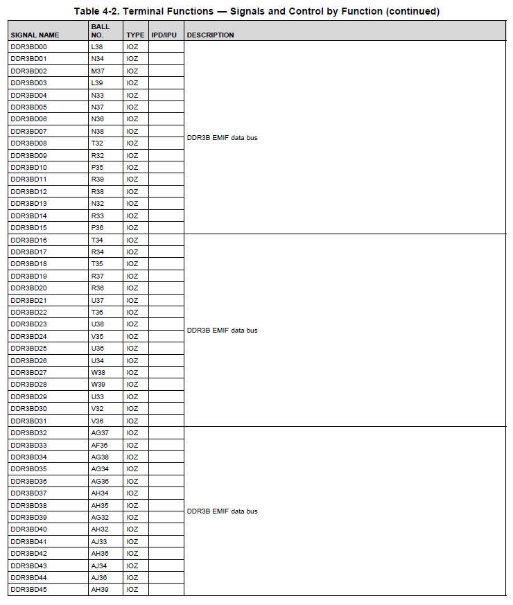

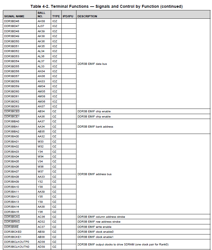

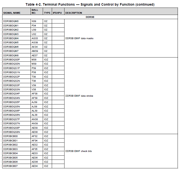

Q1) Customer is planning to use only DDR3A. DDR3B is un-used.
According to sprabv0.pdf, section 6.8.3, only clock inputs (DDR3BCLKN, DDR3BCLKP) and VREFSSTL(DDR3BVREFSSTL) need to be taken care.
http://www.ti.com/lit/an/sprabv0/sprabv0.pdf
Other signals below are must be left floating, correct?

    Q1). Yes, your understanding is correct.
