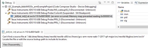

BEAGLEBK: Unhandled exception in CCS
Part Number: BEAGLEBK
After configuring PDK and CCS on other computer I encoutered some kind of - memory related project.
CortxA8: Output: PHY is READY!!
CortxA8: Output: DDR PHY Configuration done
CortxA8: Output: ****  AM335x BeagleBlack Initialization is Done ******************
CortxA8: Unhandled ADP_Stopped exception 0x80024C28
How to proceed in case of such issue?
regards,
przemek
  • Please check with the beagle board black has boot images in the EMMC and booting Linux when it is loading. When connecting using JTAG and CCS, make sure that the beagle board EMMC images don`t boot. There are multiple solutions for this that you can look up on beagle forums or in E2E.
    the region that the error is reported is DDR. Does the error occur when you load code or just when the GEL file is running. One other option to try would be to do a CPU reset and re-run the GEL initialization script.
