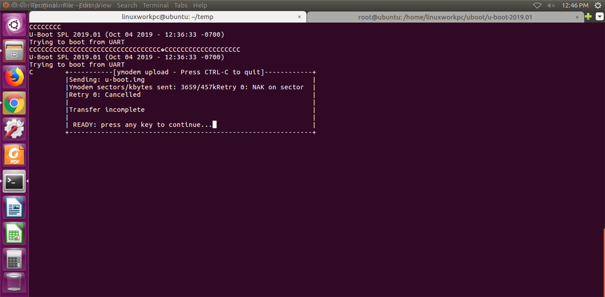

  • Hello Kemal,
    The spl and img files from linux-sdk boot properly with my board.
    I downloaded the u-boot-2019.01 code (from u-boot git) and built images.
    spl/u-boot-spl.bin : boots well
    u-boot.img : stops mid-way while loading.(log capture attached)
    Could you please try the u-boot-2019.01 (download from u-boot git) images in your environment also.??
    Adarsh
  • Hello Adarsh,
    You need to apply this patch and git check out the source under arch/arm/lib/ and arch/arm/mach-omap2/.
    Kemal
