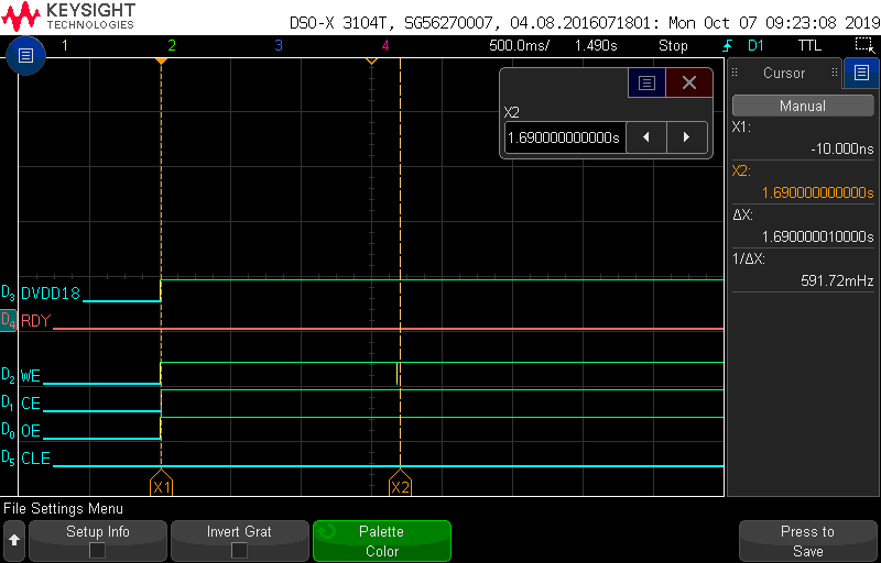

  • UPDATE,
    Joe and I scoped out the signals to see if the bootloader started at all, I don't think it did as the signals we captured only show the EMIF being powered on.
    Here are the screen shots of the signals we scoped out. I noticed that the CLE signal stays low and i never see the processor attempt any transactions to
    read the NAND.
    Are there specific moments in time where the bootloader activates?
  • Rahul,
    I forgot to include an other incident that kept reoccurring in my last reply. The WE pin sporadically toggled at around 1.6s into loading, is  this expected behavior of the RBL?

  • Rahul,
    Hello, here is a screen capture of the moment the RESETSTAT pin goes high:
    I put o-scope probes on the NAND Boot memory. I don't see any transactions on the CE or CLE. I don't know what is going on with the WE for two events.
    If we connected to the target over JTAG and write to this NAND memory is working okay and we see good signal transactions.
    We must be missing something.

  • Hello, I found that the EMIFWAIT0 was being pulled low somewhere else on the board. This is the first revision of the board and we found an error in the design. The EMIFWAIT0 was connected to an output of a buffer. Quickly found that error, lifted the pin so the EMIFWAIT0 trace was not being pulled low. We were then able to get a Ready on the NAND Flash and then program it, restart the board and then verify the data in memory. All looks good!
    Thank you everyone for all your help and comments.
