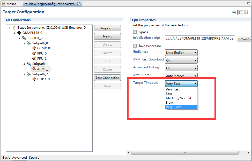

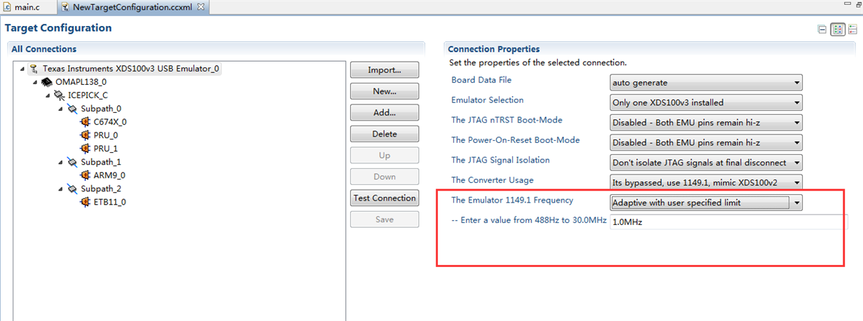

I am using the Logic Experimenter board and attempting to run one of the "Test" programs ("led_dip") on the ARM. The GEL file that comes with the board has a write failure during the OnTargetConnect() function.  Here's the GEL code:
OnTargetConnect( )
Clear_Memory_Map();
Setup_Memory_Map();
PSC_All_On_Full_EVM();
Core_300MHz_mDDR_150MHz();
Wake_DSP();
....and here's the console output....
ARM9_0: Output: Memory Map Cleared.
ARM9_0: Output: ---------------------------------------------
ARM9_0: Output: Memory Map Setup Complete.
ARM9_0: Output: Enabling Full EVM PSCs...
ARM9_0: Output: PSC Enable Complete.
ARM9_0: GEL: Error while executing OnTargetConnect(): Target failed to write memory at 0x01C11138.
Can someone give some guidance on what is happening?
