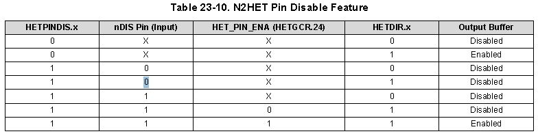

I am able to generate pwm using n2het1, but next challenge what I have faced till now, How to disable the pwm generation.
I tried gioPORTA[5], but failed to see in debug mode(I mean pwm is not stopping)
pwm generation n2het1[25], disable using gioPORTA[5]. I have enabled gio and het1 driver, pinmux is checked in both cases, pin 5 taken as input, het25 as output, interruput enabled pin5
