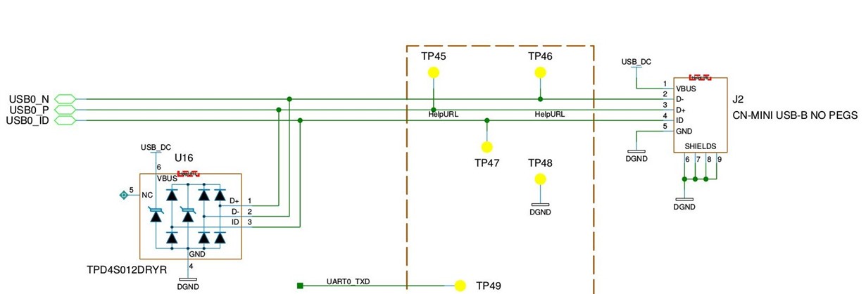

Dear E2E community,
I'm working on a custom board (BBB based) that is equipped with an USB OTG connected to USB0. We have a multi gadget configured on that port. The kernel comes from TI, version 4.14.79.  The USB works only if plugged before Linux starts, otherwise it's not seen by the OS. The module (g_multi) is probed correctly on boot, no matter if USB is plugged or not.
Once the USB is working we can unplug and plug without any problem.
udevadm does not show any event (even if the USB is working).
Any suggestion?
Gabriele
  • Hi Gabriele,
    What is the OS on the host?
    Please post the USB portion of your board schematics.
    the OS on the host side is ubuntu 16.04.
    Garbiele
  • Please run the following sequence and post the log.
    - Boot your AM3352 board without connecting its USB0 to the USB host;
    - Run the script attached below on your board and capture its output log;
    - Connect AM3352 USB0 to the USB host, and run the same script and capture its output again.

  • Please find the attached usb.log file.
    Gabriele

  • Please try use the default kernel config and beaglebone dts in the Processor SDK Linux kernel without change any USB related configuration to see if the issue still happen.
  • Hi, I haven’t heard back from you, I’m assuming you were able to resolve your issue. If not, just post a reply below (or create a new thread if the thread has locked due to time-out).  thanks.
    sorry for the late reply. At the moment I have no spare time to work on this issue, I will come back as soon as I can.
    Thank you for your suggestion,
    Gabriele
    it took me a while, but I figured out that the problem was located somewhere at gadget level (we were using g_multi): for some reason it won't works if the board is booted without USB plugged in. I did some test using libcompose and I was able to setup a composite gadget (ACM + RNDIS) that worked without any problem, no matter when the board is connected.
    Right now I have no time to investigate the g_multi issue, but probably doesn't matter since it's legacy software.
    In conclusion, if someone is facing the same problem as mine, I highly recommend to switch to libcompose + configfs (even if you are using a single gadget!).
