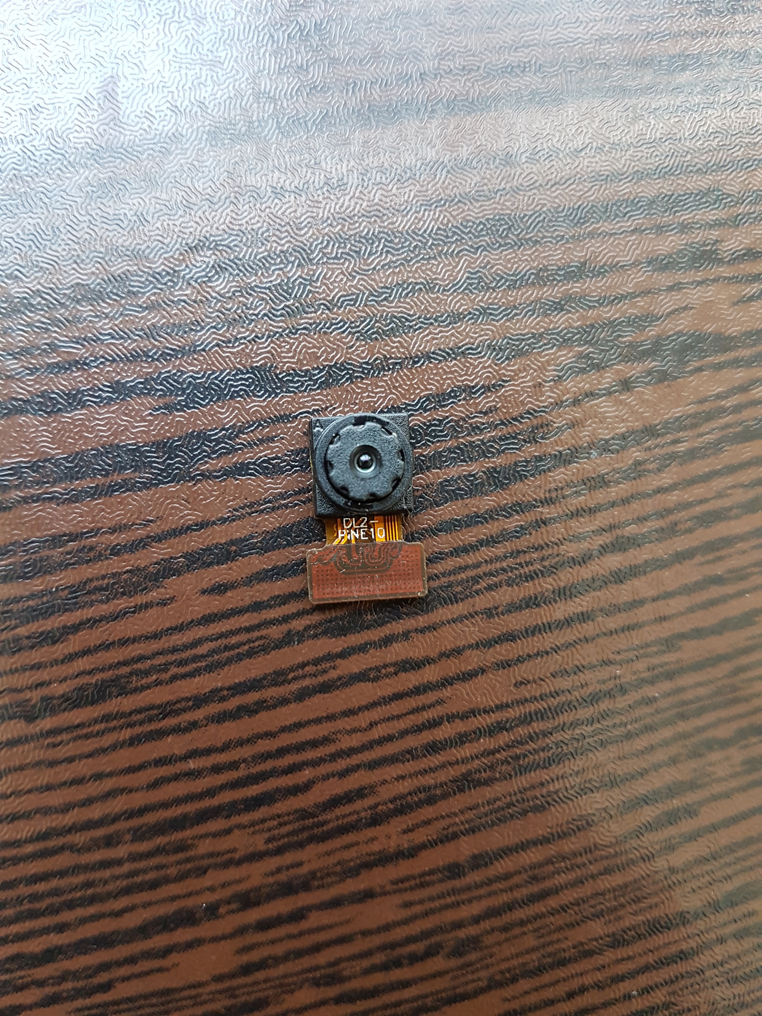

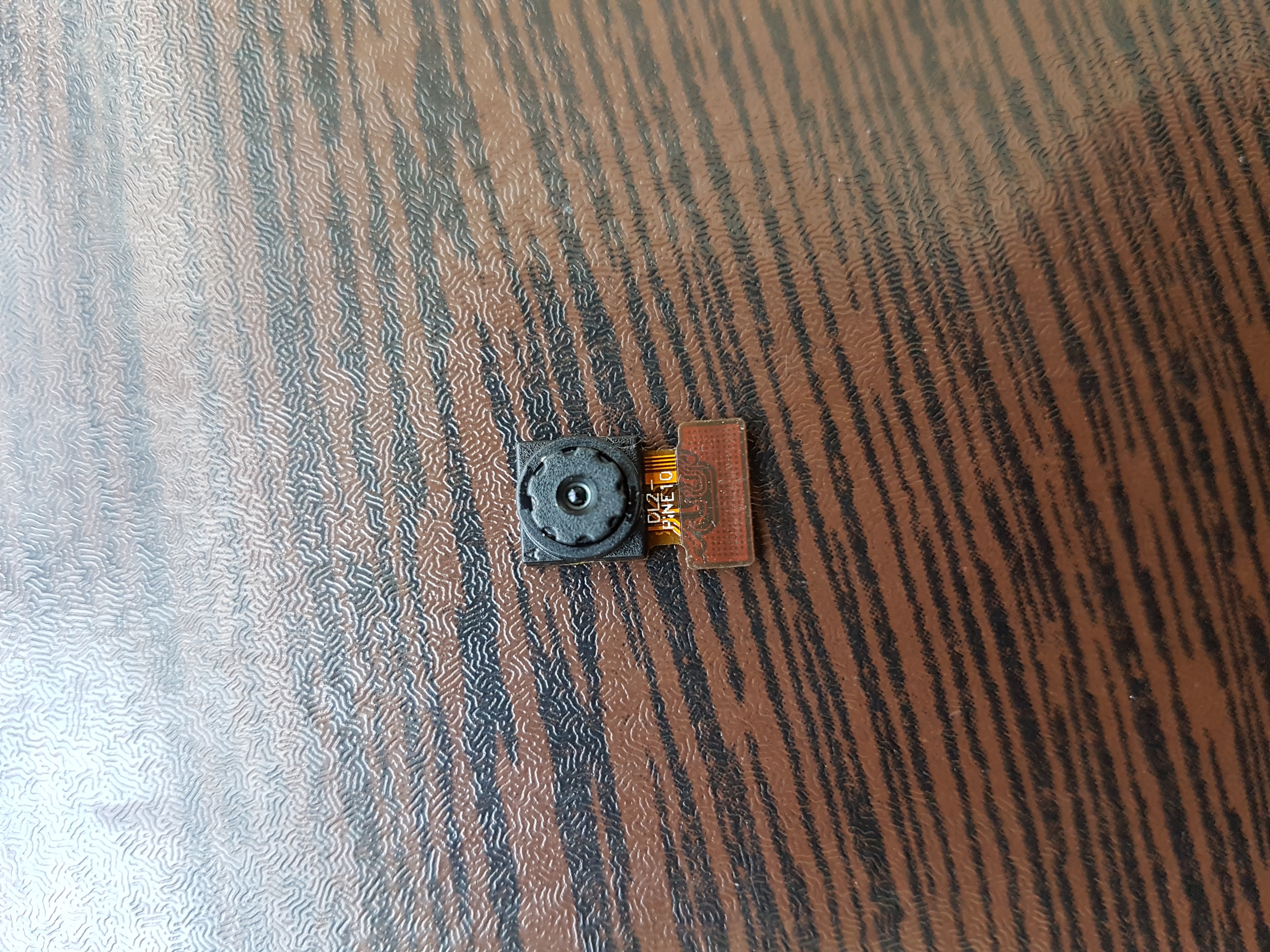

Hello everyone,
I am using am5728 IDK Rev1.3B, there is a camera shipped with it (probably its ov2659 sensor), you can see related pictures in another question of mine in here.
I'm trying to find the problem and making sure whether its the camera or the IDK, I'm using SDK Linux rt 4.9, my camera is not shown in /dev/ directory:
root@am57xx-evm:~# ls /dev/video* /dev/video0 /dev/video10 /dev/video11 root@am57xx-evm:~#
the camera is not detected by i2c :
root@am57xx-evm:~# i2cdetect -y -r 0
0 1 2 3 4 5 6 7 8 9 a b c d e f
00: -- -- -- -- -- -- -- -- -- -- -- UU --
10: -- -- 12 -- -- -- -- -- -- -- -- -- -- -- -- --
20: -- -- -- -- -- -- -- -- -- -- -- -- -- -- -- --
30: -- -- -- -- -- -- -- -- UU -- -- -- -- -- -- --
40: -- -- -- -- -- -- -- -- -- -- -- -- -- -- -- --
50: 50 -- -- -- -- -- -- -- UU UU UU 5b -- -- -- --
60: UU -- -- -- -- 65 -- -- -- -- -- -- -- -- -- --
70: -- -- -- -- -- -- -- --
root@am57xx-evm:~#
a) where can I find the related schematic for the camera module?
b) how can I make sure it's the camera and not the IDK?
c) if that's the camera, would change of the camera sensor (not the whole module) solve my problem?
any help would be appreciated.
