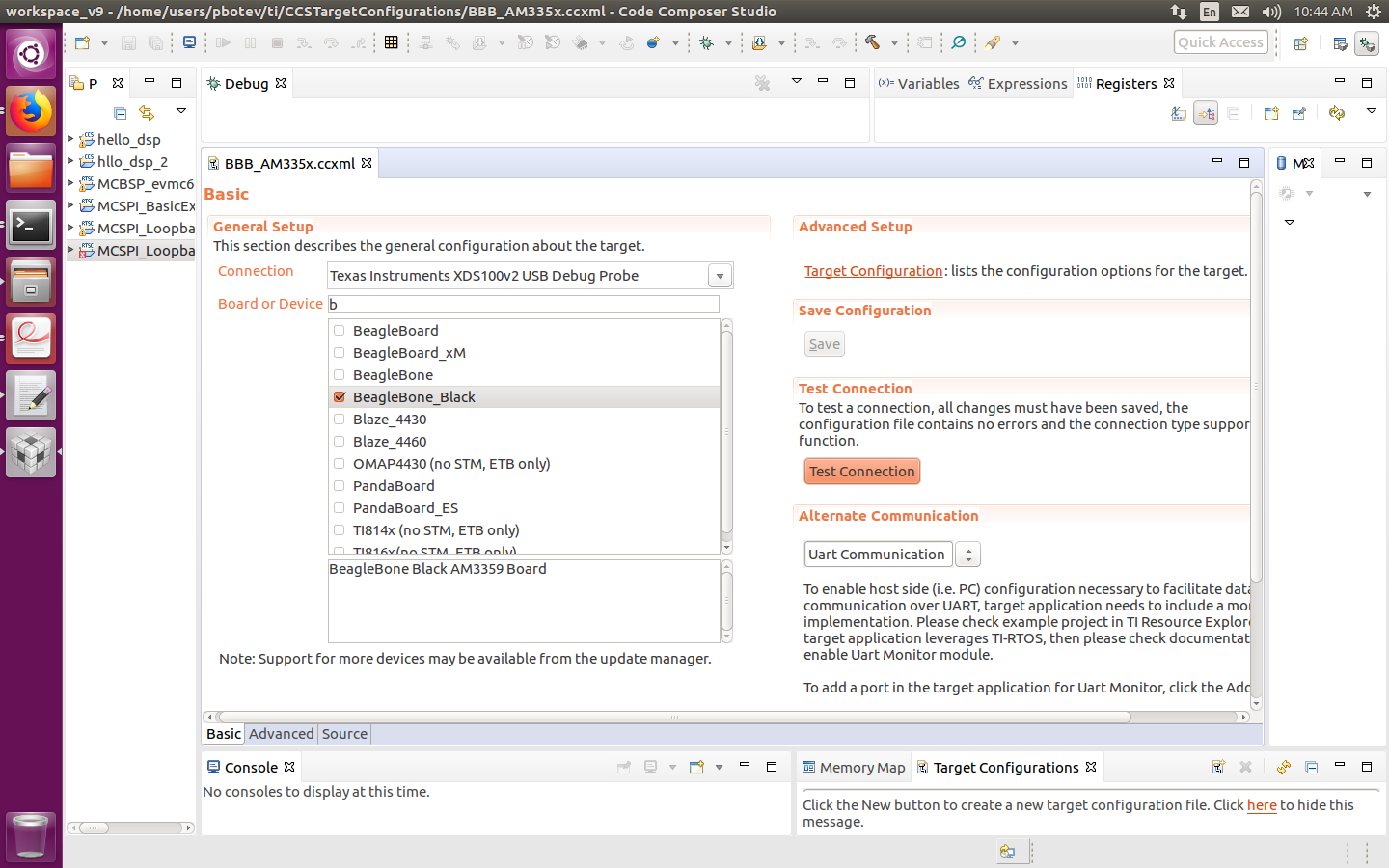

  • The system cannot find the file specified in NewTargetConfiguration
    I would suggest you below sequence:
    Open CCS 9.0.1
    File -> New -> Target Configuration File
    Rename default NewtargetConfiguration.ccxml to BBB_AM335x.ccxml
    Finish
    Connection: Texas Instruments XDS100v2 USB Debug Probe
    Board or Device: BeagleBone_Black
    Save Configuration -> Save
    Power on BBB board
    Test connection - with this button you can test if your JTAG emulator is setup correctly or not, check the result from this test
    See also below screen shot for reference:
    Pavel
