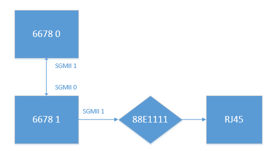

Hello Champs,
Due to the board size limitation, customer used only 1 PHY chip to save the space. He designed his own board shown in below block diagram. C6678 1 device can connect to PHY successfully. But C6678 0 can't connect to the PHY.
1. Is the above daisy chain design feasible?
2. If it is feasible, how to configure the SWITCH to get it work?
3. If it is not feasible, is some other method to connect the C6678 0 to the PHY?
Thanks.
