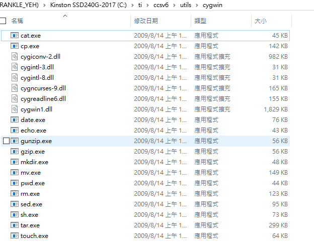

    c:\PROCESSOR_SDK_VISION_03_07_00_00\ti_components\algorithms\REL.TIDL.01.01.03.00\modules\ti_dl\test>C:\ti\ccsv6\utils\bin\gmake CORE=dsp all
    /usr/bin/sh: c:\ti\ccsv6\utils\cygwinmkdir: No such file or directory
    c:/PROCESSOR_SDK_VISION_03_07_00_00/ti_components/algorithms/REL.TIDL.01.01.03.00/makerules/rules.mk:375: recipe for target '.\out\\.gitignore' failed
    gmake: *** [.\out\\.gitignore] Error 127
    I have checked that c:\ti\ccsv6\utils\cygwin is exist.
