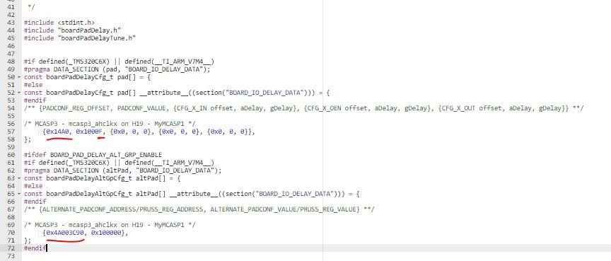

    So we've looked into this. Let me try to explain this in one shot. Basically, you are having an alternate mode to the driver off mode in function 15 on these balls. I think the easiest way to study the alternate modes is with the PinMux tool. It gives you a GUI perspective on these things: https://dev.ti.com/pinmux/
    Let's take an example. In the tool, go ahead and configure mcasp3_ahclkx on H19. If you look closely, you will see it is in function 17 (anything beyond function 15 is an alternate mode). if you generate one of the C files available, you will see the configuration in code, as shown below:
    And if you cross-check this in the TRM, you will find that 2 registers need to be configured for this signal(mcasp3_ahclkx) to be re-routed to pin H19.
    - CTRL_CORE_PAD_VIN1A_D5 (muxmode 0xF) and
    - CTRL_CORE_SMA_SW_14 (0x100000)
    By the way, these alternate options are pretty well explained in table "Pads Having Capability for Additional Signal Mapping" in TDA2Px TRM. However, these indeed are not included in the TDA3 TRM. I will check with the documentation team, and will update the TRM accordingly.
