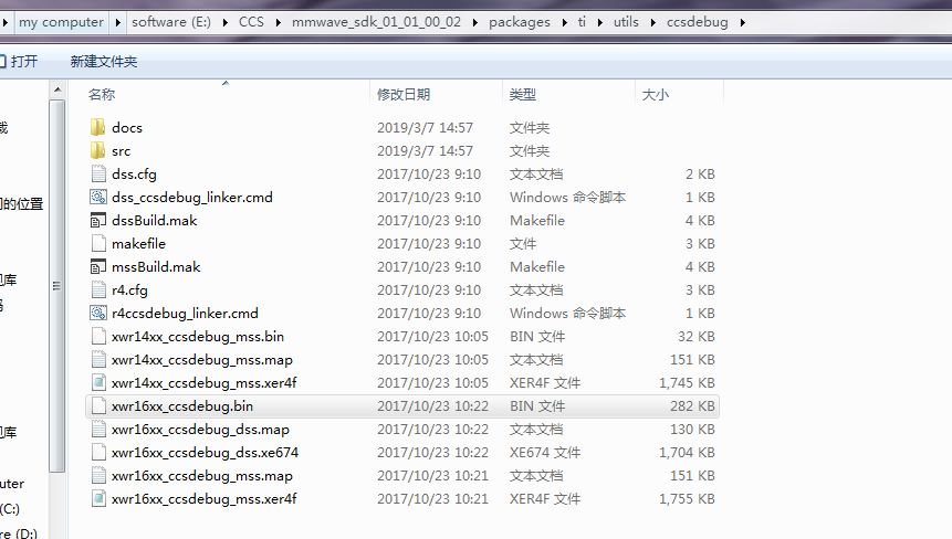

  • Hello, through inquiry, I found that when I was debugging on CCS and board online, I used SDK2.0 files, and the board burned SDK1.0 ccsdebug internally. My project was adjusted in this kind of environment.
    May I ask if there is any way I can make bin file be generated normally in this case?

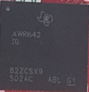

    The first thing to identify is if you have an AWR1642 ES 1.0 or ES 2.0 silicon.
    ES 2.0 shows similar to the attached picture.
    If you have ES 2.0 silicon you MUST use mmwave SDK 2.x. SDK 1.x will not work

  • Indeed, as you said, I checked the chip for IWR1642, and the content is similar to the picture you gave me.I rewrote SDK2.0's ccsdebug, but I reported an error during debugging (I used SDK1.0's ccsdebug before also because of the error). The error content is as follows:
