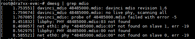

I was tring to make the ethernet interface working fine these days. But it seems that the mac controller cannot detect the phy chip.
dmesg info:

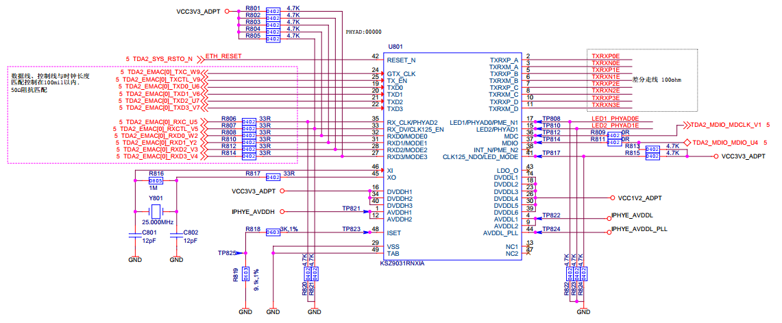

The following picture is the phy schematic.
I got two questions here.
1. The ifconfig command list three ports(eth0, eth1, lo), while i have disabled the cpsw_emac1 in the dts file. As we have only gmac_sw0 used in our board, how should i disalble the eth1 interface?
2. What should i do to make the eth0 interface working fine?

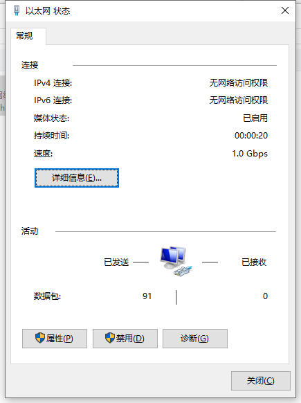

Another fact is that if i conect the board to my pc. I can get the connection information from the windows side as follow.
In my opinion, this may say that the phy chip is working, but the mac layer cannot make communication with it.
I am very new to linux kernel development. Hope for your reply.

    But the phy chip still cannot be detected. Can you provide some debug suggests on that?
    Liu Gan
  • Hi all,
    A strange phenomenon.
    If i configured the mdio_clk & mdio_d pins to output, then i can get wave output from the mdio_clk line.
    But if i modify the mido_d pins to i/o, as common understand, then i get nothing from both the mdio_clk and mdio_d lines.
    Hope further help on this problem.
    Liu Gan
  • Hi all,
    Finally i found this is a resistor place issue.
    We add two 0 Ohm resistors in the mdc and mdio lines. But they are proved to 150 KOhm......
    After we replace the two resistors, the ethernet working fine.
    Liu Gan
